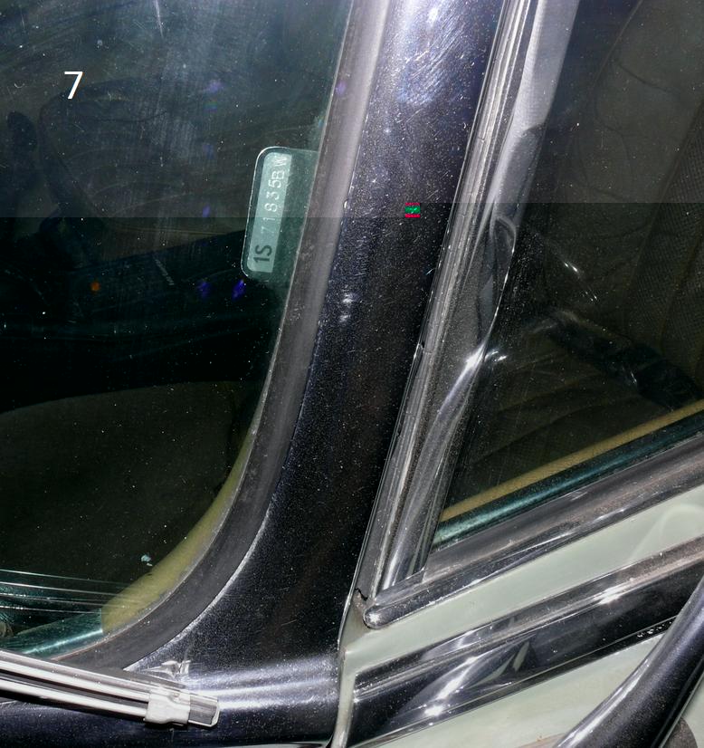

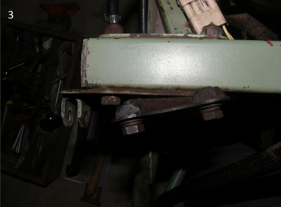

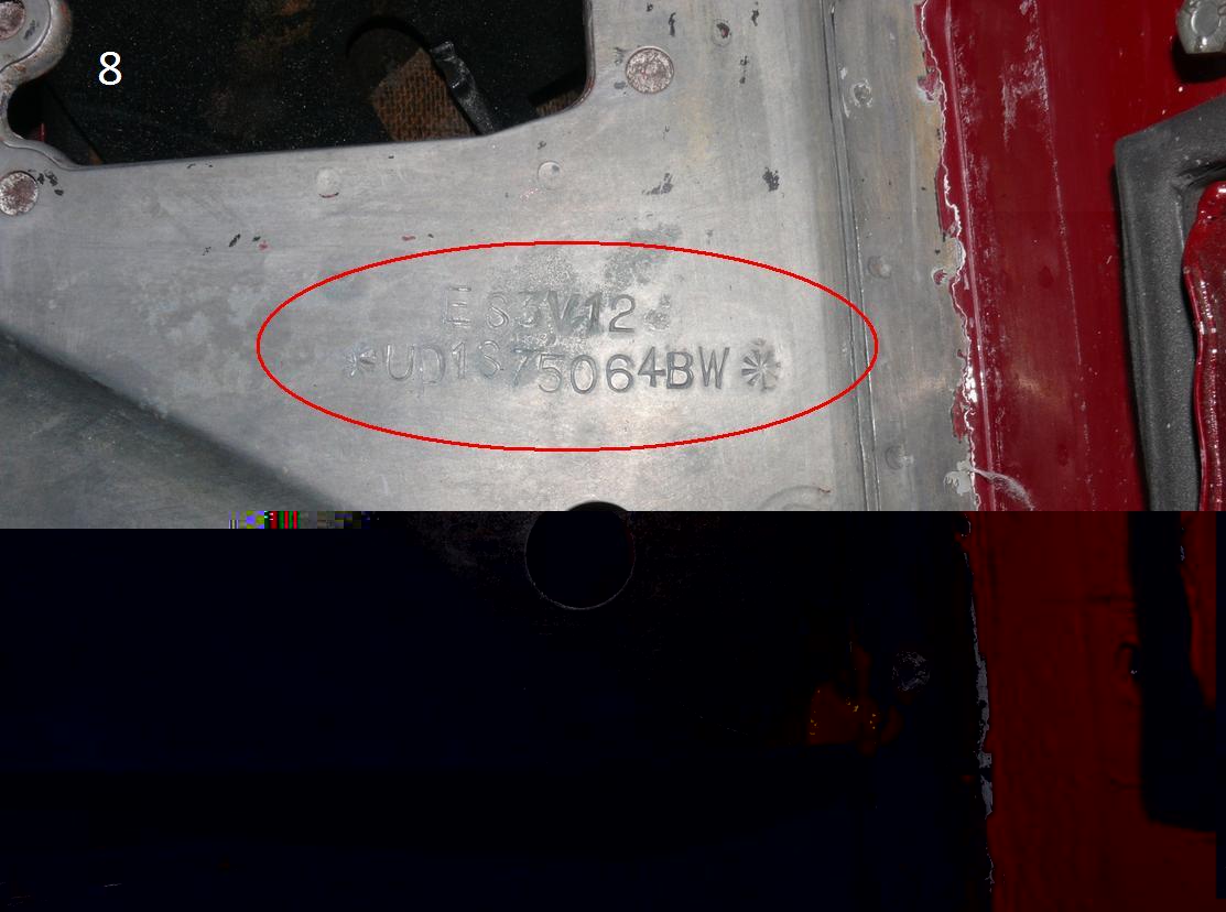

#7 Re: New VIN plate
Hello Christopher,
Clearly you're confusing an S3 with earlier cars. The following pictures show:
1. the VIN on the tag riveted to the Left Hand windscreen pillar
2. the VIN (referred to as CAR Number on the Firewall Plate) stamped on the sloping surface at the Left Side of the Firewall
and
3. the absence of the VIN on the Right Side of the Picture Frame.
In the picture showing the VIN stamped on the Firewall, the aperture in the Firewall, visible just above the VIN, is for the mounting of the Pedal Box for a LHD vehicle. This is covered by a Blanking Plate when the car is RHD.
S3 cars also have a Body Number (not to be confused with Car Number) stamped on a small aluminum tag that is attached to the rear beaver panel, high up and roughly centre, width-wise, behind the rear registration plate.
and
