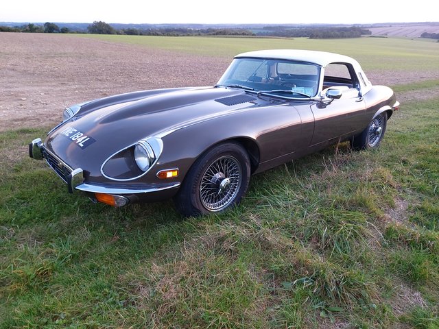

Thanks for responses, hints and tips, weekend's work clearly identified. Colin, mine is a cinamon brown as well! Expansion tank, didn't know about that, i'll investigate.
