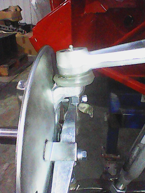

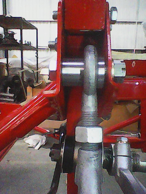

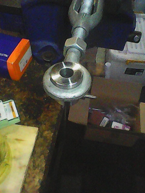

A 10cm height difference is quite considerable. and I know you stated that the engine had no fluids, and the interior is missing, but is the rest of the car in place, such as the Bonnet, Radiator, etc?. That would make a difference. As the Sherlock Holmes character said, "When you have eliminated the impossible, whatever remains, however improbable, must be the truth".
The following two pictures shows the arrangement 0f the Turnbuckle Tool I use. Once the Torsion Bars have been installed with the Turnbuckle Eyes set to the correct Centre Distance, I shorten the distance between the Eyes of the Turnbuckle so as to put the suspension in circa the position it would be if the weight of the car was applied. I leave the Turnbuckles in place until the end of the work on the car, so that the Grease Gators, particularly the top one, are not in a contorted form for a long period.
The following two pictures show the machining of the inside of the Turnbuckle Eye so as to be a close running fit on the bush shown installed in the next picture down.

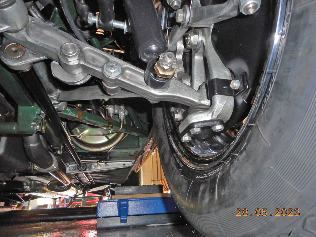

In the image you can see that the angle of the lower wishbone is much too steep. The shocks are still extended to their max. There is no spring action basically. Not even when I apply my own weight. It is as if the suspension is stuck somehow, but I do not see how, other than a very stiff bar with way too much pre-tension.
