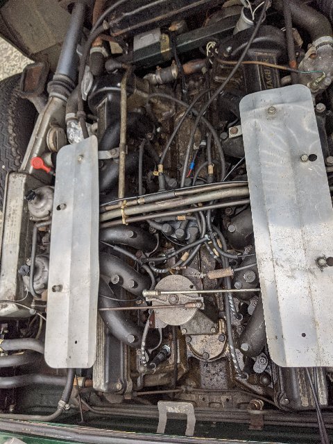

Other than cooling system (and brakes), the ignition system is the most important aspect to look at. Again, judging by the condition of your car, I would not be surprised if its still fitted with the infamous "OPUS" ignition system. If so, that MUST come out immediately and be upgraded with something modern, either the ignition system from an XJS (cheap if you can find a system - dissy, AB14 ignition module and dual coils) or from Lumenition. Post a pic of the valley of the engine from dissy to waterpump please. Also send a pic of the flying saucer thingy on the side of the dissy.

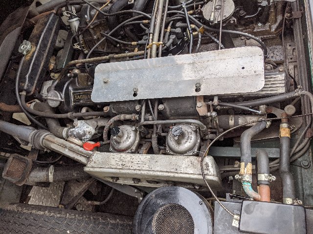

JoeLondon wrote:
Sun Mar 15, 2020 4:00 pm
Seems from this pic that the cowling that should be mounted on top of the exhaust manifold is also missing. The hot air duct from the air cleaner should plug into the cowling covering the exhaust manifolds on BOTH SIDES.
Best Regards
Philip

I think the dizzy and coil look ok and upgraded.
Not sure about the wood screw in the vacuum on the back n/s carb. Something to do with the missing hot air pickup hose and the question over the thermostats?
Something did move when I sucked on the nipple (nothing new there :dance:)
Anyway, she's going to doctor Moss tomorrow, who has a list as long as an e-types bonnet.
Joe

OK, ignition wise, things don't look standard anymore.
If the flying saucer thingy on the back of the dissy has a nipple pointing to the dissy, it should be replaced with one (JLM519 from SNG) that has the nipple pointing away from the dissy (another one to suck on :bouncyyellow: ) . Connect the vacuum nipple to permanent manifold vacuum. (Don't let anyone tell you to start drilling carbs!!)
It looks as though the original OPUS ignition module has been moved to the picture frame, but its impossible to tell what it is. If it is original OPUS, then, for your own peace of mind, replace it with either a Lumenition system or replace the entire dissy, ignition module with the dual coils from an XJS (latter might be cheaper).
