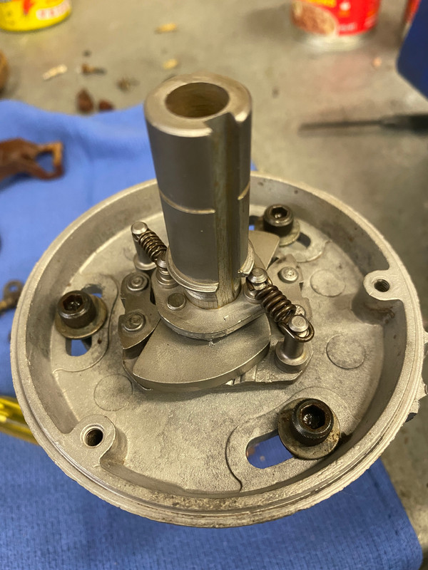

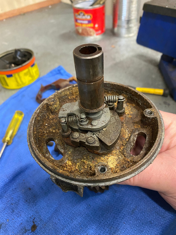

This is what your dizzy might look like inside...
Before.
After.

Post by Craig Balzer » Sun Jul 14, 2024 4:11 pm
After
Is that result of using an ultrasonic cleaner??

Posts: 4126
#25 Re: Condensation in distributor
Post by abowie » Sun Jul 14, 2024 9:44 pm
No I stripped it, cleaned it and rebuilt it.
This was the one I machined for the sealed bearing.
