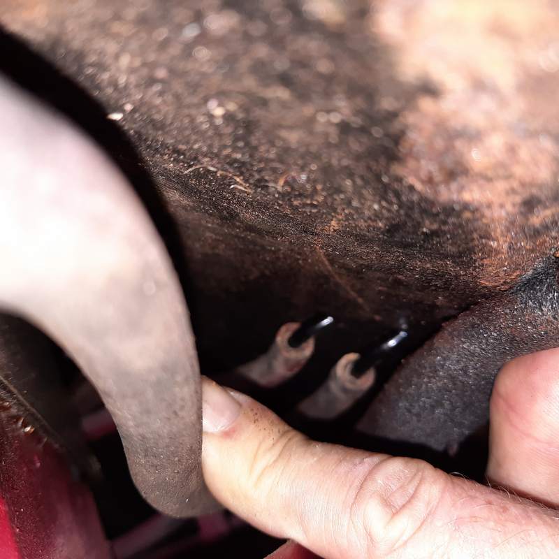

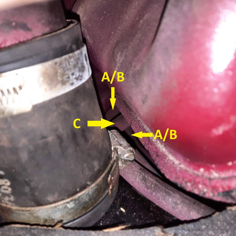

I went and had another good look and I found all 4 of them breather pipes. Just extremely hard to see. I applied compressed air (at about 0.2 bar) to the vent pipe and could hear air being blown into the tank (which is near empty) and out of the small hole in the fuel cap.
The two pipes are labelled "A/B" because I can not see which is which.
C is certainly the expansion tank drain pipe.
tn2_20210409_114709 annotated.jpg (72.2 KiB) Viewed 79681 times

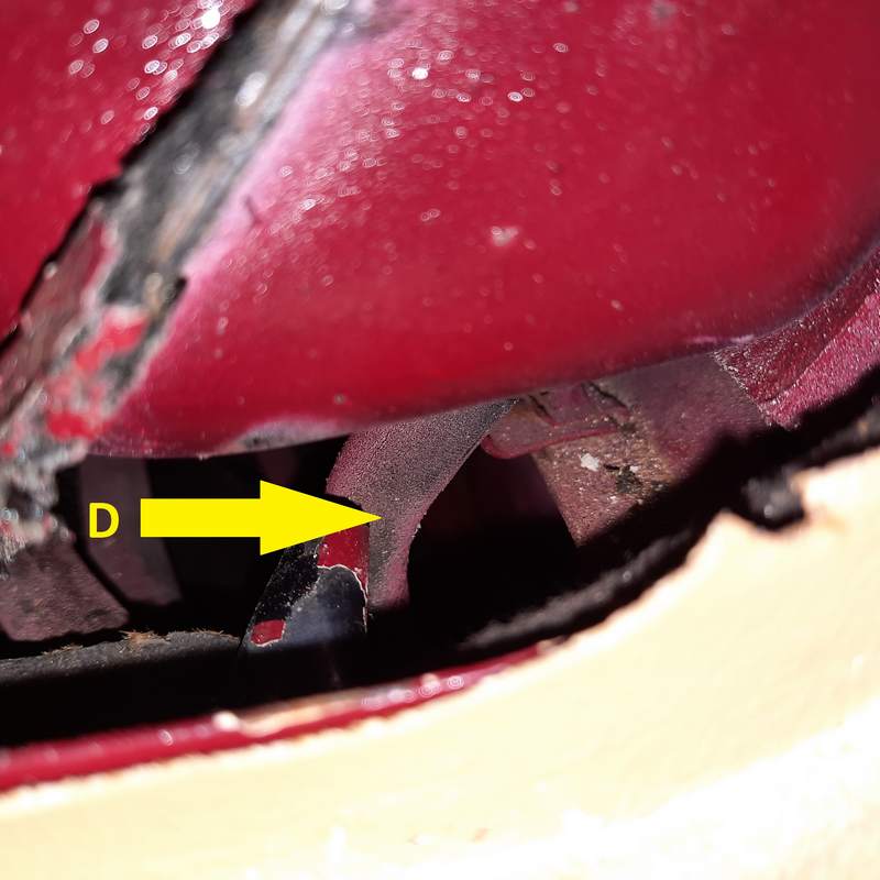

Here is the vent pipe D. The red above the yellow arrow is the bottom of the expansion tank.

My finger is pushing the vent pipe D away to reveal the A and B connections to the tank. They seem to be much further to the rear than the OTS.
Best Regards
Philip

Are you following the "A" and "B" nomenclature from the S3 schematic in post #23? If so then it looks as if your "C" and the "A/B with a horizontal arrow" are the wrong way round and the expansion tank won't drain back to the main tank.
It doesn't matter which of the the two outboard connections on the expansion tank (A & B on the S3 schematic and 1 & 2 in the S2 diagram below), go to which of the two rearmost vent connections on the main tank as functionally they are the same.
It does look so in my pic but I THINK the second "A/B pipe left arrrow" goes behind the first "A/B pipe down arrow" but its impossible to see where it connects to the tank. This would put both A and B pipes on the left most side of the expansion tank - as per the see through drawing you so kindly posted.
