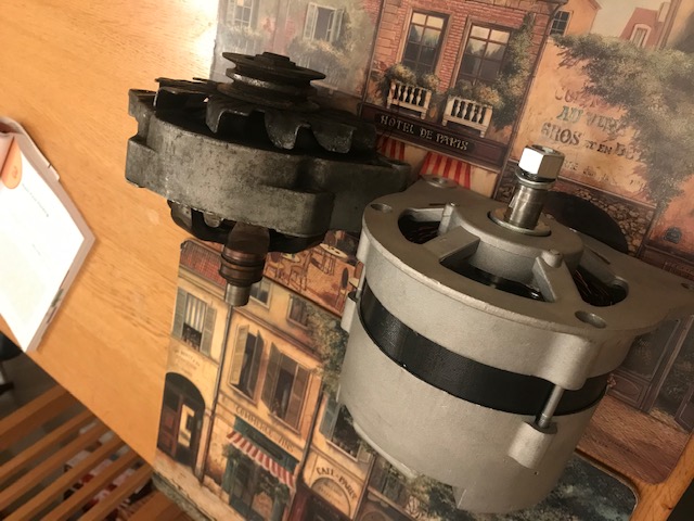

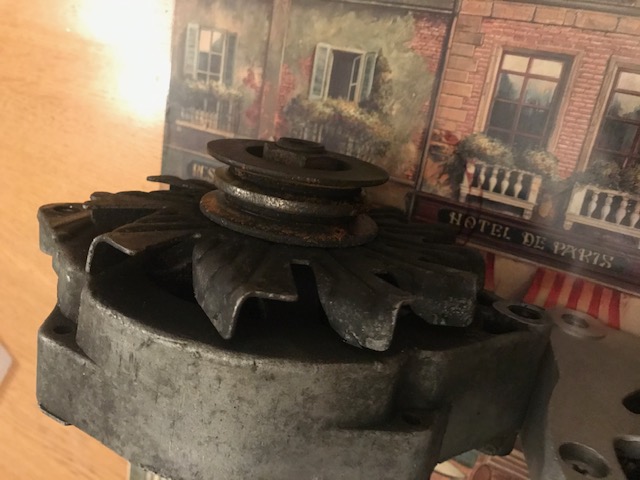

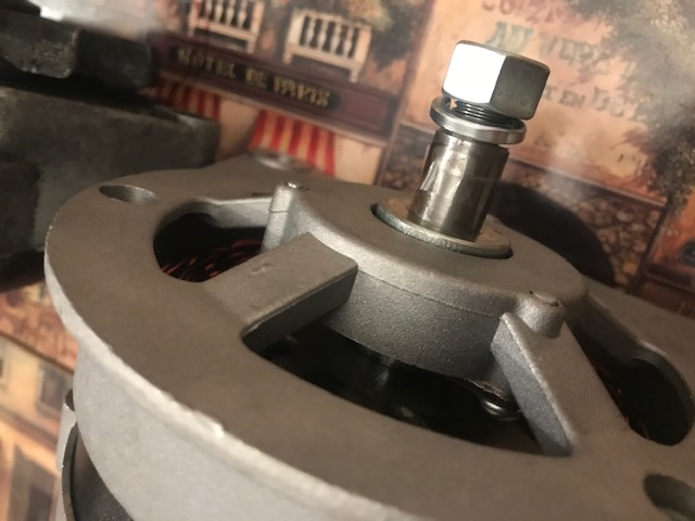

lowact
Posts: 775
#48 Re: 130A alternator upgrade
Post by lowact » Thu Apr 22, 2021 11:50 am
I couldn't resist. new 60 A alternator versus old:
93 mm frame size, smallest available. They go up to 90 A in this size but 60 A seems to be the price sweet spot.
As with most new aftermarket alternators it has an internal fan, that pulls air through from the pulley end. If I was to mount this like the Butec (pulley to the rear) it would be trying to push air against the natural air flow. So I will fitting this baby pulley forwards, in place of the air pump ...
