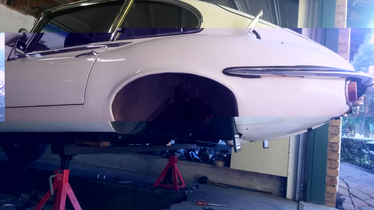

Yesterday, I had the opportunity to drop the Independant Rear Suspension (IRS) from a friend's E-type for the first time. I really did not look forward to it but it turned out to be easier than pulling the engine/tranny combo.
I simply suspended the car high on two trestles with a substantial U-shaped iron bar and supported the IRS on my rather substantial trolley jack, loosened everything, and dropped it.
Lesson learnt:
1) loosen then IRS mountings from the IR, NOT from the body. It is very difficult to get the nuts back onto the the mountings with the IRS in place;
2) disconnect the handbrake cable when the IRS has dropped about 4" (100cm);
3) replace the IRS mounts by fitting them to the car, not the IRS.

At most two hours, including lifting the car and supporting it some way to work on the IRS.
I should add that I have a large workshop trolley jack which did make lowering and raising the IRS really easy.

Its pretty much impossible to disconnect the handbrake cable with the IRS in the car. Once its lowered about 6" (15cm) it is much easier to disconnect the handbrake cable.
