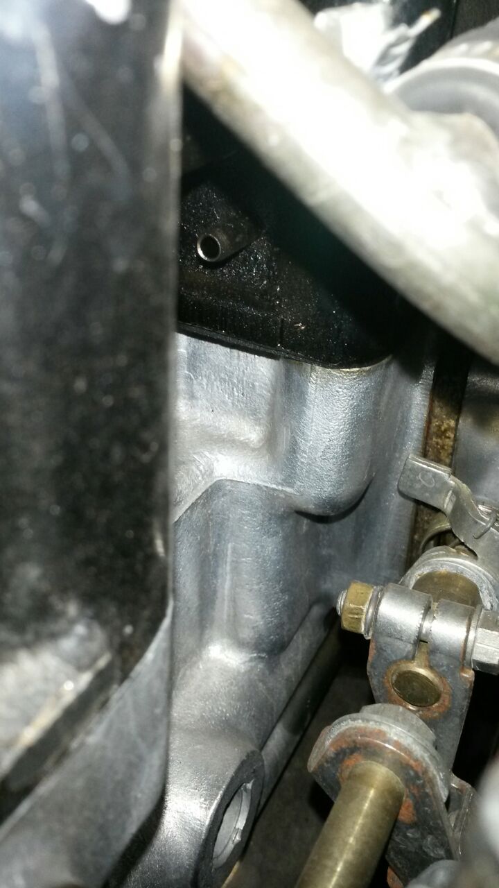

I found a vacuum port on my car that must have been open for years....
It sits on the RH bank, on the front banana branch, between the front and rear banana intake branch, below the larger vacuum tube that connects the front and rear banana intake branches.
What is it for?
One can see it here on this pic of spare RH manifolds. Its the small one below the larger ports that link the front and rear manifolds:
Here it is on the car, taken but it might be hard to actually spot it:

They connect to the air filter intake, air flow control flap. I believe the flaps were designed to assist very cold starting. The seals in vacuum units in mine leaked so I blanked the vacuum ports on the manifolds on both sides.
There may be one on the left bank to the dizzy - not sure off hand.
I blanked all mine off with silicon caps available on eBay. As I mentioned in anouther post there is multitude of potential induction leaks on a V12, ensuring there are no leaks is essential to obtain correct air/ fuel mixture.

Yes that's correct, that port had a vacuum line to the flap in the forward portion of the intake trumpet on the carburetted cars. I also have disconnected mine, and just blanked that port. There is one on the other side as well.
Its not for the distributor, that vacuum comes from the LH rear carb, either on top if you use a vacuum advance module or underneath if the car has a vacuum retard module fitted, the retard module was only fitted to the 1971 year I think.
