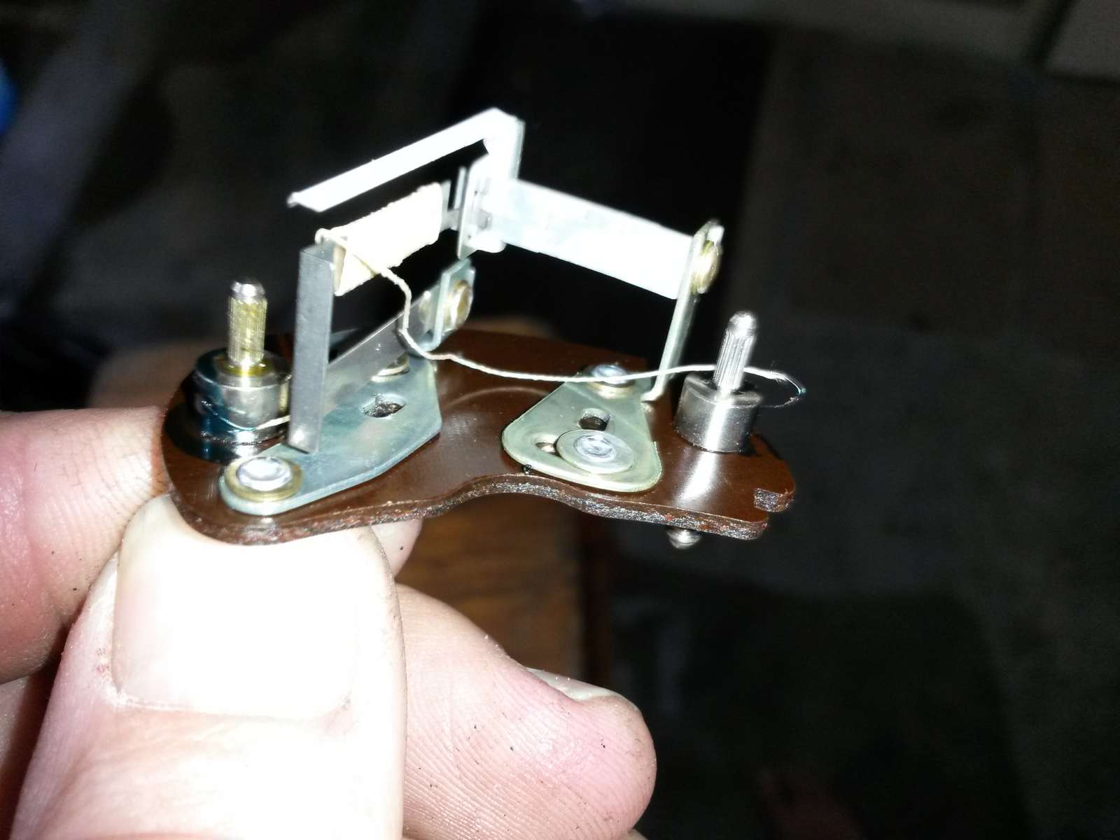

I recently rebuilt a Series 3 for a friend (mechanically only) but found that the temp gauge was reading much higher than what I would expect. At first it was sitting on the L of NORMAL and during a recent drive it moved even higher to between the L and H. New sensor made no difference.
Long story short, upon opening the gauge, I found that the wire to the right in the picture was touching the enclosure of the gauge. I believe this led to a partial short which allowed additional current to flow through the gauge, causing the gauge to display higher values that it should have.
Having moved the wire away from the enclosure, it now displays the exact same values of the gauge in my own car:
N (of Normal) = 3.95V (over the two terminals)
L = 5.6V

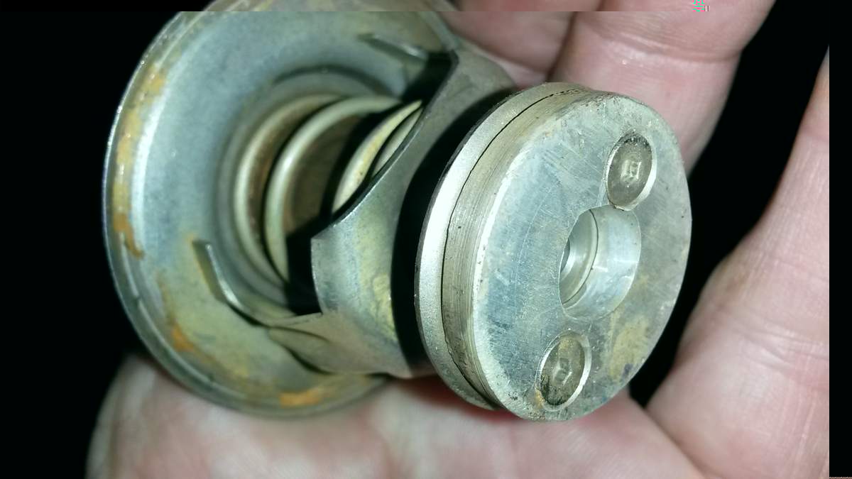

This over reading of the gauge persisted even after I fitted the voltage stabiliser, gauge and sensor from my own car to the car in question. I also installed a temporary wire directly from the sensor to the gauge to eliminate possible shorts to ground on that wire.
Yesterday, I decided to remove the 82ºC thermostats and replace them with other 82ºC thermostats to which I've added a 3mm washer to the "bypass port blocking plate". I tested the ones removed and those installed and all are fully operational.
Now the temperature sits stable between R and M of NORMAL.
Conclusion:
1) The bypass port valve of the thermostat(s) did NOT close the bypass port in the thermostat housing causing a coolant "leak" via the bypass circuit and thus SOME coolant kept on recirculating through the engine and not passing through the radiator. This caused the consistently high temperatures being measured.
2) I had tested / measured those thermostats that were installed to be sure that they moved far enough to block those bypass ports but clearly they allowed enough "bypass leakage" to cause a problem.
The really interesting part is that the engine displayed no other symptoms of overheating, no smells, no dumping of coolant, the fans would rarely run for longer than 15 seconds after switching off.
