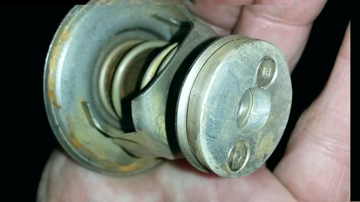

3) Modern Thermostats do not always move far enough. That plate at the bottom end of the thermostat must physically close the bypass port in the thermostat housing. If this does not happen, hot coolant just keeps being recirculated through the engine. I bolt 3mm washers to my thermostats to ensure that the bypass port is closed - see pic below. You can measure the distance from the thermostat ridge to the bottom port and then you can boil the thermostat in a kettle to measure how far it moves;

This would not be sensible (possibly even dangerous) without first somehow closing the bypass ports. Doing so (without closing the bypass circuit) would surely result in the engine rapidly overheating?
Consider that the bypass cooling circuit is intended to warm the engine up quickly and is meant to be blocked by the thermostats once they are open and certainly offers an easier route for coolant to pass through than through the radiator.
Even if the engine somehow does not overheat, it still would not a good test to test the cooling effectiveness because we are interested in the temperature behaviour with coolant flowing ONLY through the radiator.
