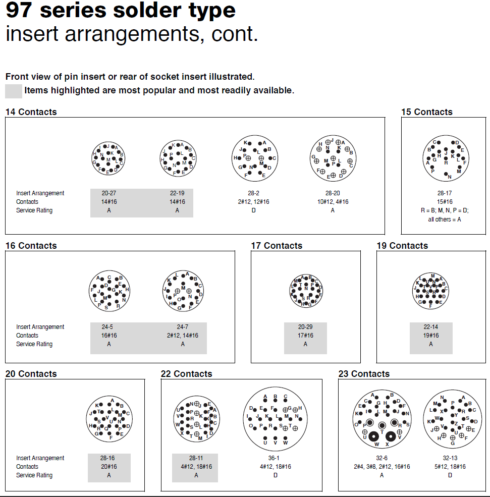

Another option would be to find a large "feed through" / "pass through" bulkhead connector (with enough pins), where you can mount the bulkhead connector into the steering collumn cover plate and terminate the wires (now cut to length) to connectors that plug into the bulkhead connector on either side. Then it won't even look like the wires were "cut" to length.

Found some nice Amphenol connectors from a catalog here: http://www.amphenol-industrial.com/literature/catalogs
Amphenol connectors.png (99.63 KiB) Viewed 27478 times
