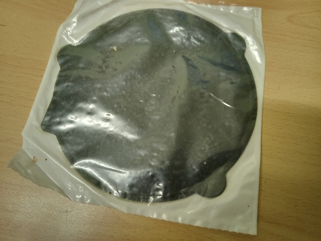

I really appreciate all of the advice here. SNG Barrett says the XJS vented cap won't fit my distributor which according to my repair manual is 36DE12 rather than 35DE12 but I think I'll order one and see how it goes. There's also the suggestion that there might not be a gasket between the cap and the distributor, and there's certainly not one shown in the parts manual so that's another avenue worth exploring. In the past, whenever this problem has presented itself it's been dealt with by a mechanic so I can't say for sure if there's a gasket or not. What I can say is that it's time for me to put my fear aside, stick my head under the bonnet and, within reason, start pulling things apart. Many thanks to all of you.

Also check yr crankcase ventilation system, if this is clogged, not working as it should, a direct consequence could be more condensation in your distributor.
Next I’d try the distributor cap gasket, if air can’t get out, condensation can’t get in? Its not an o-ring, it’s the perimeter of this:
My understanding, such gaskets were not part of Opus distributors (35DE12). T’was not till about 1986, the CEI ignition system for the HE engines, the 36DM12 (vacuum advance) distributors had dedicated ventilation system due to the increased amount of piston blow-by from the high compression engines. It does fit the earlier distributors also.
To repair the distributor shaft seal you have to dismantle the distributor, including remove/replace the drive gear. The seal is NLA, solution is to replace the bearing with a modern sealed bearing, to fit this you have to machine the distributor housing.

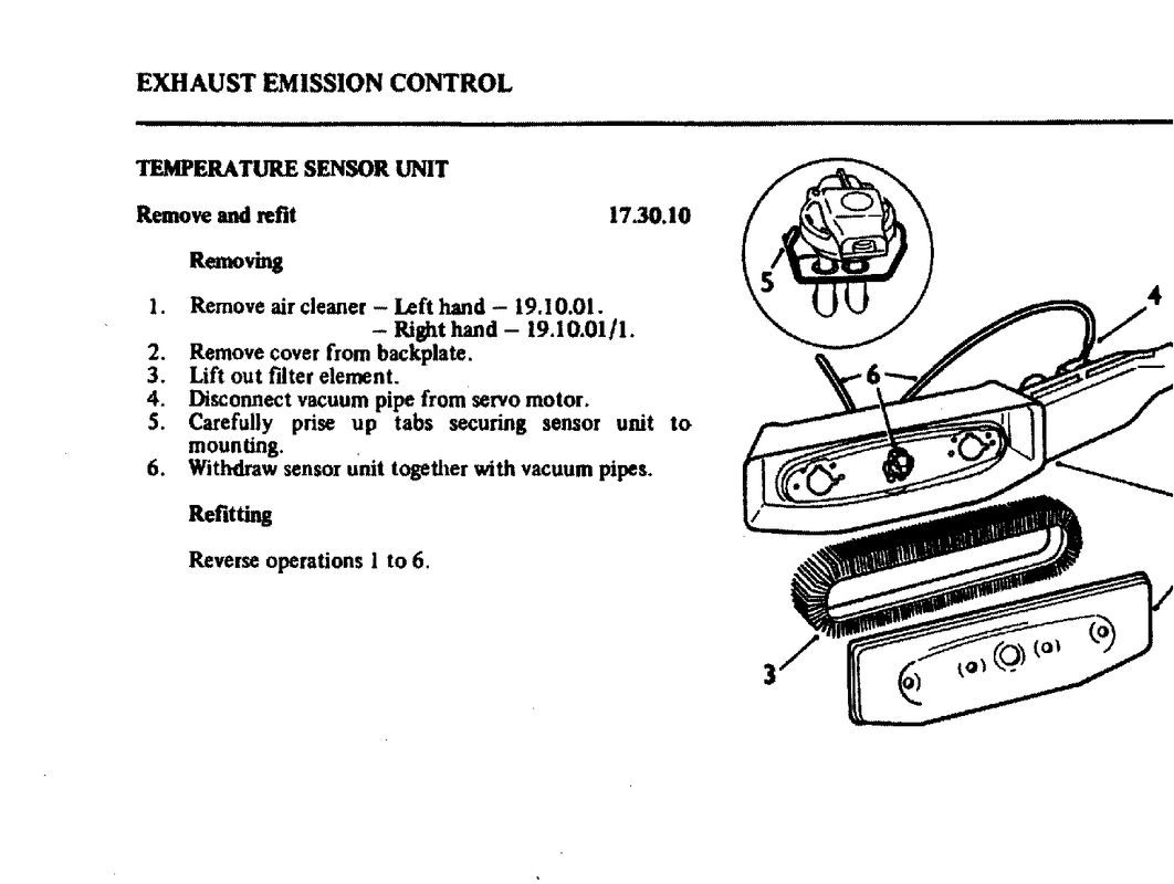

#20 Re: Condensation in distributor
I can see that there is a vacuum pipe attached to each air cleaner (item 4 in attached scan). Is this where I connect the hose from the side vent on the distributor? If so, do I need to fit a t-junction?
