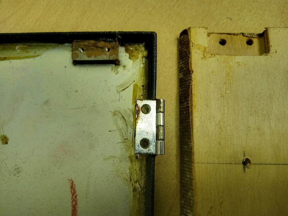

Can’t help directly but these maybe of some help:
1965 S1 4.2 FHC (early)
:wavegreatbritain:

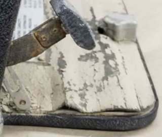

The wooden insert (looks pre-covered here) may well glue in place as there doesn’t seem to be separate screws for it:
https://www.martinrobey.com/part/122068
https://www.martinrobey.com/jaguar/e-ty ... acia/19407

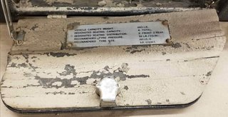

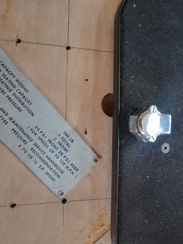

My Series III is LHD so these may help

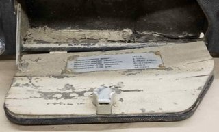

Its just a piece of piywood, minimal glue, mostly held on by the latch. Covered by black velvet on a cloth underlay. Note the door handle screws are just into the plywood. if yr making this, might be opportunity to build a stronger handle connection ...

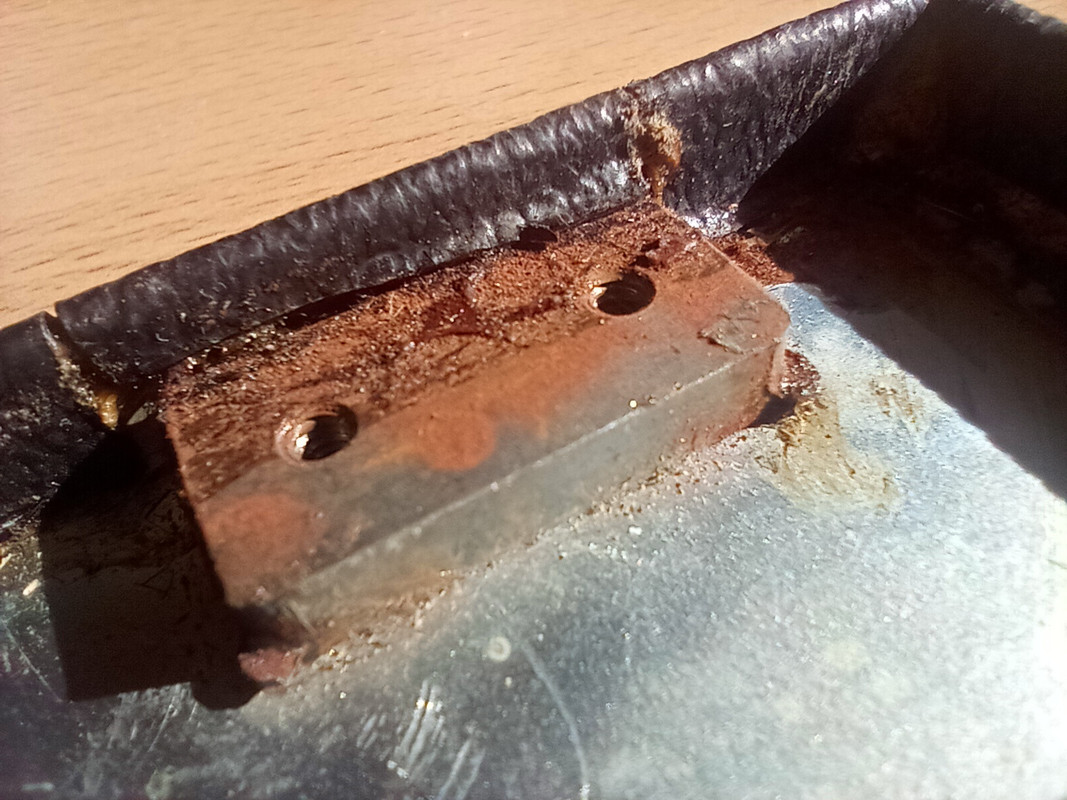

The metal block seems to be somehow stamped/riveted to the lid. Maybe a spot weld process although I can't see heat marks. Whatever, it is definitely part of the metal fabrication process, not possible to attach in this manner after the vinyl covering. Imo the part you buy should have this block.

Thanks for the picture, I am going to try to file off the corners and see if I can remove it, and then attach it to the new door.

My LHD to RHD conversion, the RHD panels were from an S2, means I don’t know if the differences are because of the series or the market (LHD/RHD). Original (LHD S3) had a tyre details plaque on the inside of the glove box lid; the replacement (RHD, S2) doesn’t. And the replacement (S2, RHD) glove box lid has a funky flush fitting “nut” for one of the door handle screws, making it a lot stronger than the original (S3 LHD) s/tap screws into plywood.
