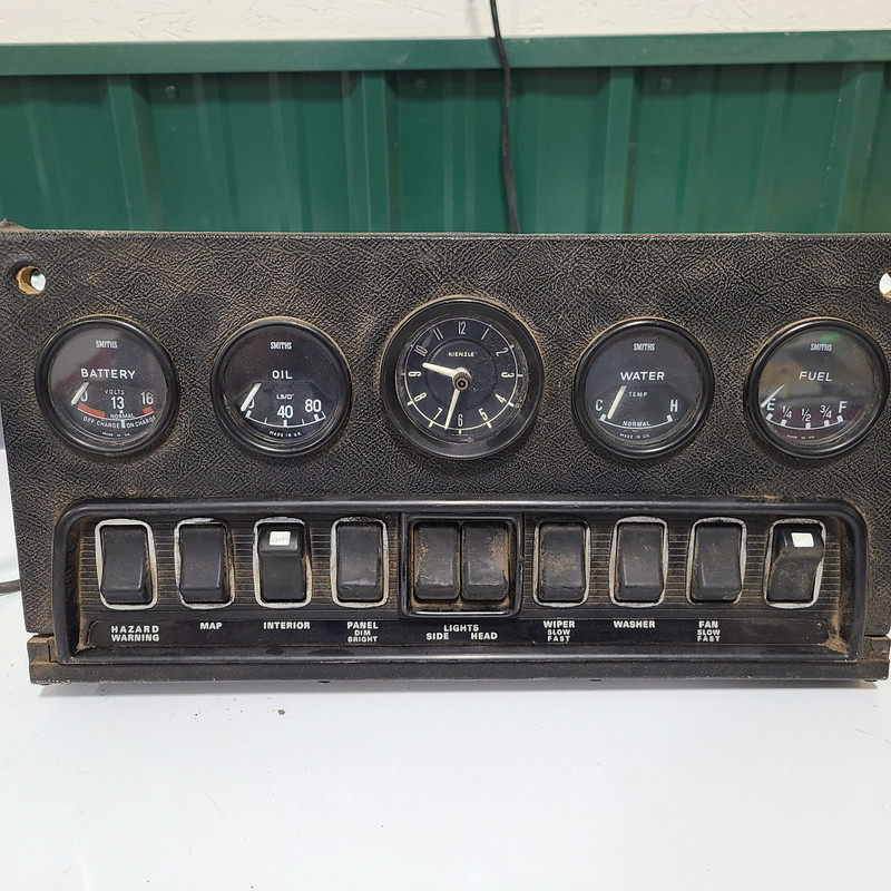

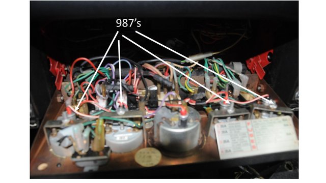

987's: battery, oil pressure, fuel level and water temperature - 1 each
turn signal indicators - 2
hazard warning indicator - 1
speedometer and tachometer - 2 each (4 total)
ignition, low fuel, high beam indicators - 3 total
brake fluid/handbrake warning - 1
That's a total of 15

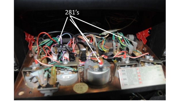

281's: choke warning lamp - 1
choke detail panel - 1
clock - 1
oil pressure warning - 1
air/heater control panel - 1
seat belt warning - 1
rocker switch labels - 3 total
That's a total of 9.
