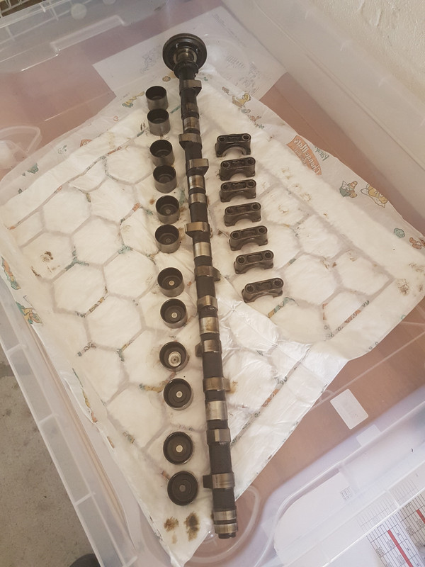

Today it was warm enough to start working on the tappet clearance. I found it very easy to take the camshaft out. For the tappets I used a strong magnet. Fortunately there is no wear visible.
Thanks again for your comments. Beeing new to Jaguar the forum is really helpful for me.
