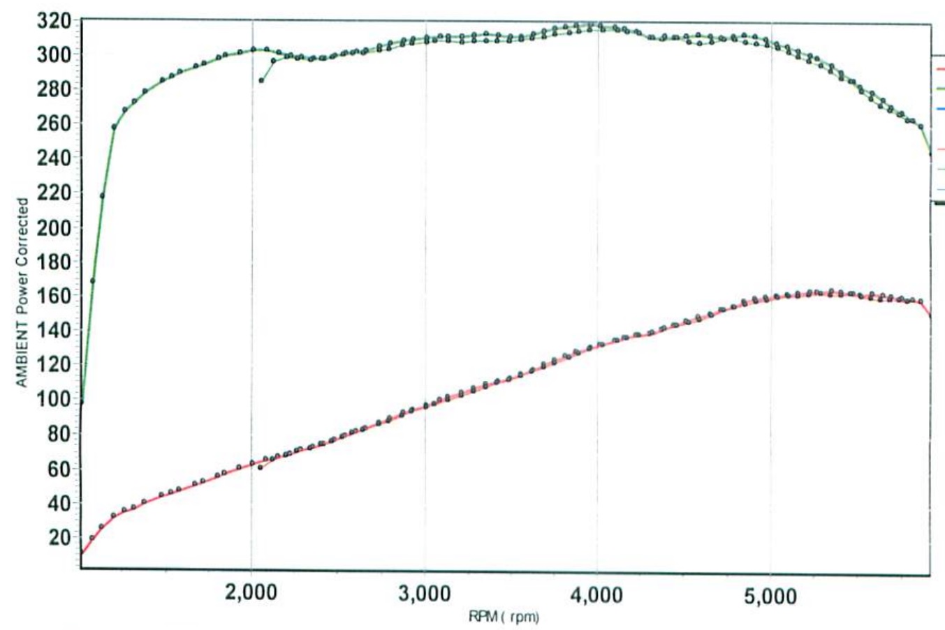

I find specifically your V12 HE torque graphs rather interesting! Below the dyno graphs of my ex E-type which had the 11:1 HE + EFI conversion. This run was done at 1800m AMSL where normally aspirated engines lose between 15-20% of the power compared to sea level.
On my graph you will see that they did two runs. The first only started around 2000rpm but then I told them to start at 1000rpm which they still got wrong (only "mad people" are interested in torque at 1000rpm....)

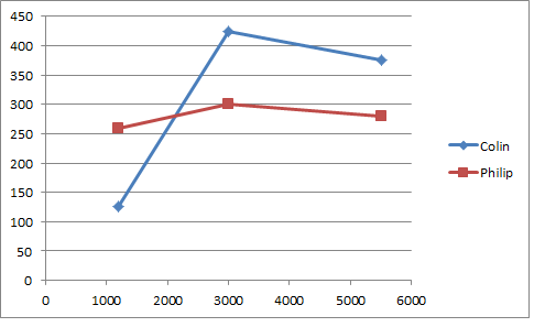

Now some observations:
1) The SHAPE of the two curves is what attracts my attention.
2) Your torque graph seems a lot more curved - not just because the graphs are scaled differently but it really seems as if your engine needs to rev to deliver torque. I've plotted the main points on the same graph to eliminate the graph scaling effect below.
3) It again shows how things can vary from dyno to dyno; My dyno graph has a correction factor called "Ambient" and was set at 23%. No idea what the implication is of that.

Hello Phil. The performance curves I posted are not my cars, not even real, they are copied from automobile-catalog, this uses car dynamics simulation software i.e https://www.automobile-catalog.com/simulation.php
:lol: In that case, I can be more direct. I think those curves are seriously flawed.
I was blown away by how flat the torque curve on my S3 OTS was. But it did confirm how the car felt - strong, very strong, from idle to 5500rpm. This is why my XJS is so happy with its Tremec 5-sp doing 2000rpm @ 120km/h. I recon it would be just as happy if it could do 1500rpm @ 120km/h.
