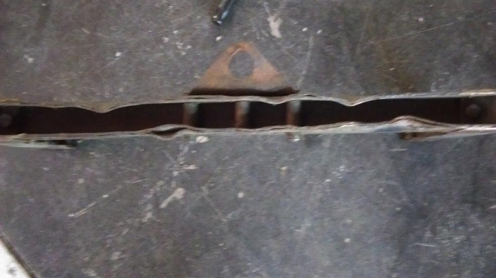

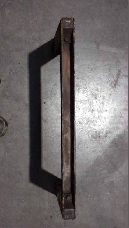

The removal of an S3 Picture Frame is eminently possible with the engine in situ. We do this on quite a regular basis when having to repair the lower member, damaged through inappropriate use of a jack.
Before Repair
After Repair
Also when stripping a car for restoration, we normally support the engine, remove everything around it (engine frames, picture frame, etc) and then move the engine away when all is removed.
Before Repair
After Repair
