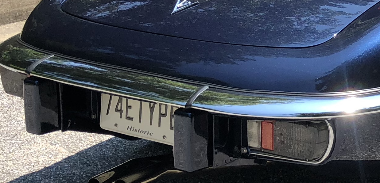

Take a look at David Lacey's website for how to deal with the front bumpers without losing the functionality of the extra protection offered. At the rear, you may need to drill out some spot welds to release the rear cradle. Your new rear over riders will sit about 1" away from where the Euro spec ones do, but no one will notice. Without the stainless steel finishers it'll look a bit like this. You'll need some grommets to fill in the various left over screw holes.

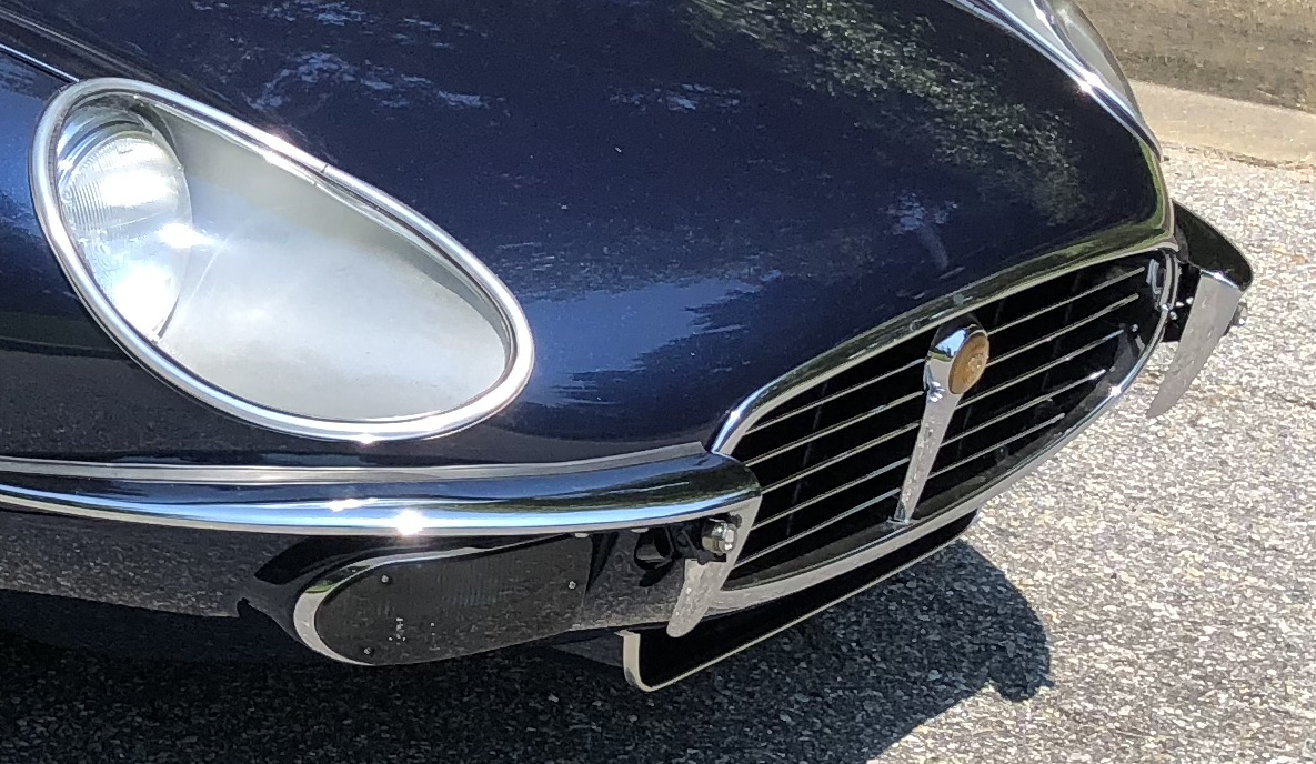

I got rid of my US train bumpers at the front as well. Made my own version of how I think they should look, but the rear set up with the added strength had some appeal to me because of the added protection in case of a low speed rear end collision.
I basically shortened the huge rubber buffers and had them painted in body color.
Each to his own, here is mine.

Looks quite nice - I didn't realise it was such a job to change them over all the fittings are different - David Lacey is suggesting new blades as well.

I agree...front end looks fantastic !! Great solution to Jaguar's disaster (thanks to US Fed regulations....can't just blame Jaguar ! LOL ). Bravo !
