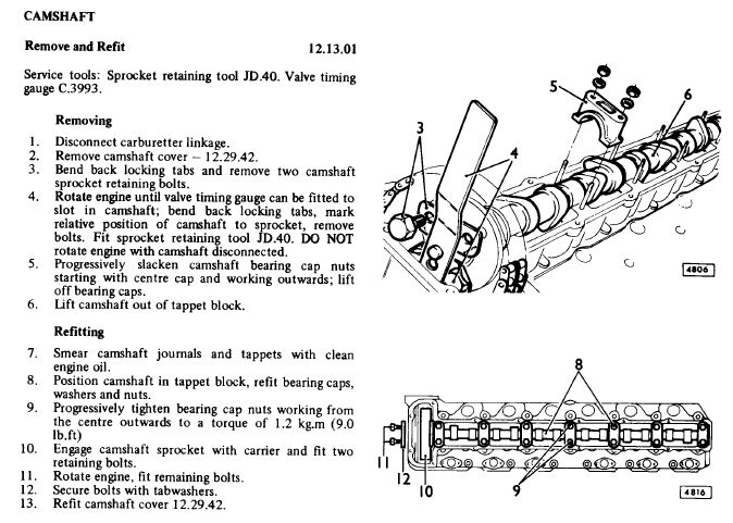

Today it was warm enough to start working on the tappet clearance. I found it very easy to take the camshaft out. For the tappets I used a strong magnet. Fortunately there is no wear visible.
Thanks again for your comments. Beeing new to Jaguar the forum is really helpful for me. :thankyouyellow:
Sven
'71 S3 coupe LHD manual
MarekH
Posts: 1753
#12 Re: tappet clearance
Post by MarekH » Sun Feb 17, 2019 5:38 pm
I've never bothered with the chain tensioner tool. Once you have undone the four bolts holding the camshaft sprocket on, you can get it back on just by pulling a bit and if necessary, helping it along a bit with a big long screwdriver down the right hand side. There isn't so much tension in the tensioner that a bit of elbow grease and leverage can get past.
Similarly, unless you want or need to change the cam timing, the cam tool isn't needed either - just don't undo the circlips inside the camshaft sprocket. It can then only go back on one of four ways and if you can't remember where the notch was when you undid it, you really ought not to allowed near a stripped engine.
What you DO need to do is to do up the cam cap bolts to a measured and equal torque using a torque wrench each and every time as the flex in the camshaft (once it is pulled by the timing chain) can pull your valve timing measurements out by 1 or 2 thou because the front end of the camshaft will twist from the pull of the timing chain.

I should add that you don't even remove the sprocket from the chain. Just unhook the sprockets from the camshafts, tie the sprockets and chain up together and hang them up where they are.
You also don't want the distributor rotor arm to be pointing a different way prior and post stripdown. (That's what the jackshaft retaining tool achieves without taking the distributor cap off.)

Only thing I found a little bit difficult was to get the bearing cap nuts back on because it's necessary to compress some valve springs. It should be easier if someone helps.
But finally I got everything back in. Of course I use a torque wrench because I'm always trying to be very precise.
Finally my wife (who also is a mechanical engineer like me) said that this engine is no swiss wathch but "only" an engine. :bigrin:
Only thing I couldn't find in the manual was the tightening torque of the sprocket retaining bolts.
Due to the locking tabs this might not be too important so I will tighten them with 20Nm.
Thank you again for your advice. :thankyouyellow:
