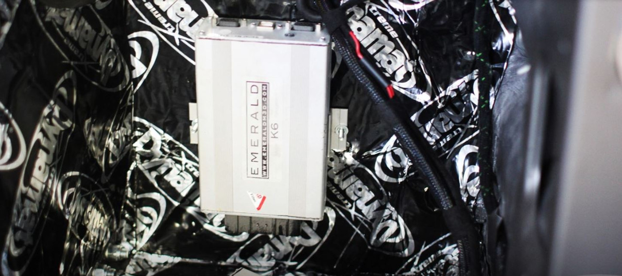

Finally after thinking and get an oportunity, I ve purchased a K6 Emerald ECU to get a fresher solution to manage both injection and ignition.
It will replace the 2 ECUs from the donnor XJS I ve got with the v12.
Because I get it from a guy on Ebay, It comes with a Lotus map.... A few work to do soon.

I see that the Emerald K6 can only handle high impedance injectors (14 - 16 ohm). This is normal.
The jag injectors are low impedance.
In the FAQ of Emerald's web site they say that one can run low impedance injectors with K6 using ballast resistors. This is only partially correct. Using ballast resistors is OK for racing applications but its NOT GOOD for road applications where the engine will spend lots of time idling and on light throttle, both of which requires short pulse widths where ballast resistors DO NOT WORK WELL.
Solutions would be to either change your injectors to high impedance, or you will need "peak and hold" injector drivers from diyautotune.com which will make wiring quite a bit more messy.
Best Regards

I add about this ECU that 2 of the last V12 E type restored by Etype UK are equipped with this K6 ECU.
It should be said at the same time if the original low impedance injectors and fuel rail were used or high impedance injectors.
I say again. Using current limit resistors IS NOT a good solution for a road car.
REASON: they slow the time the injectors require to open, down. But even that is not the main problem. No two injectors are the EXACTLY the same. One way in which they differ is that they do not have THE SAME opening time. Current limit resisors also INCREASE the DIFFERENCES in opening times. This results in significant differences in fuel delivered by different injectors when small pulse widths are required (idle & light throttle). Then some cyls are running overly rich when others are running too lean = engine unhappy.
I'm not saying K6 is no good! I'm JUST pointing out that it does not handle low impedance injectors and I AM saying that if you want to use it, then please also fit high impedance injectors. Do not be tempted by the resistors approach. MS-3 and most other ECUs don't handle low z injectors which makes MS-2 somewhat unique.
