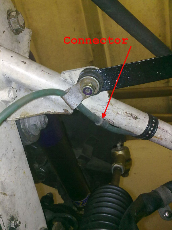

Hi Gerhard,
This might help you find the join. Looking from the car centreline above the steering rack (LHD) out to the left.
Bob
