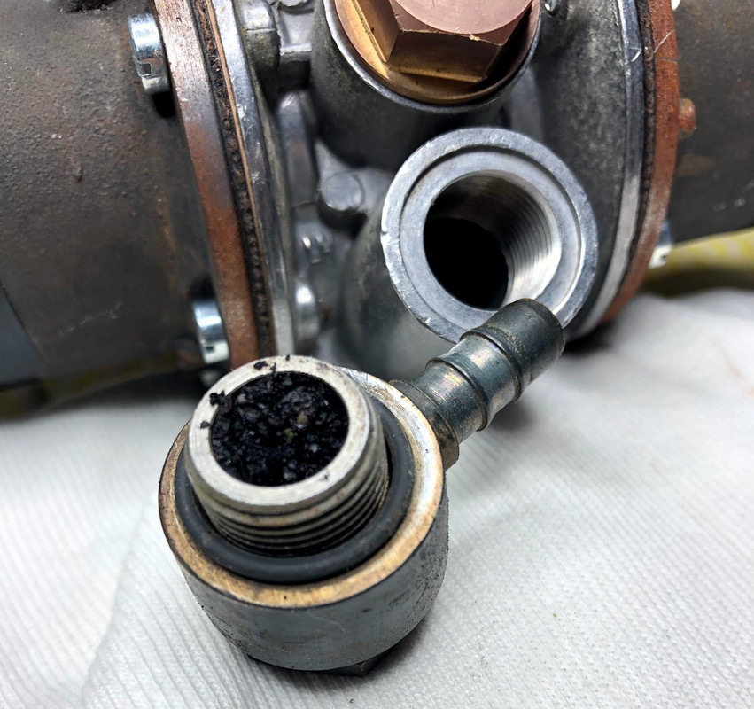

rossco_j
Posts: 43
Joined: Fri Feb 15, 2019 2:58 am
Location: Queensland, Australia
#5 Re: fuel filter and fuel line
Post by rossco_j » Mon Dec 02, 2019 11:33 pm
Thanks Garry,
That photo was taken just after the fuel tank had been cleaned. Lots of muck had been removed & a lot deposited in the fuel pump. It was just a precaution. The car had been stored for some time. When the tank was refurbished, I didn't find a gauze filter on the pickup in the tank. The filter may have been removed by the previous owner. No problems with vapour lock though.
Ross

AussieEtype
Posts: 635
#6 Re: fuel filter and fuel line
Post by AussieEtype » Tue Dec 03, 2019 12:10 am
Wow - that is not good - I can understand you putting that filter in - my point still remains valid though but I would leave that filter in place until you were happy the crud was no longer coming through. If then car stops on a hot day you know it will be either vapour lock or that filter getting clogged up. I assume you have cleaned that tank out.
My comment about a coarse gauge mesh filter was an assumption on my part - I assumed there is one (not checked my own) as every other car I have has one in the tank pickup - including my 50s landrovers - though you have some fine sediment there and the coarse in tank filter will not stop that.
You must have been getting a bit of sediment in the main glass bowl filter.
For the OP - while your system is not as original, the fact that your filter might bounce around a bit, with the spare etc all in place all will be good.

rossco_j
Posts: 43
#7 Re: fuel filter and fuel line
Post by rossco_j » Tue Dec 03, 2019 12:40 am
I've checked the parts manual & I can't see a gauze filter. I will move the filter to the output of the pump once the car is on the road.
Sorry to hi-jack the thread...
Ross

Posts: 4154
#8 Re: fuel filter and fuel line
Post by abowie » Tue Dec 03, 2019 1:11 am
The brass gauze filter goes in at the top of the glass bowl above the paper filter.
Personally I would always fit an additional cheapo inline filter in the fuel line as the E Type tanks are usually full of crap.
rossco_j
Posts: 43
#9 Re: fuel filter and fuel line
Post by rossco_j » Tue Dec 03, 2019 5:19 am
Andrew
What are your thoughts regarding my setup of the el cheapo paper filter between the tank and the inlet to the pump? Should I put a filter at the front of the car prior to the carbs?
Ross

Posts: 4154
#10 Re: fuel filter and fuel line
Post by abowie » Tue Dec 03, 2019 6:32 am
My opinion is just that; opinion, so take it as such.
I like to have a plastic inline filter between the tank and the fuel pump. I don't want big chunks of rust in the pump.
I inspect then regularly and change them if they look to have much crap in them. They're about $5 from Repco. Nothing ought to get past them so I'd be happy with things as they are in your car.
All my cars are S1 cars and I do have the glass filter/paper element in the engine bay but they never seem to get much in them as anything should get caught by the inline filter. Also, SUs have a mesh filter in the entrance to the fuel bowl. I'm not sure what the arrangement is on S3 cars.
Of my cars one has an original tank that I've never had out, one has an original that I cleaned out with hydrochloric acid and pebbles and one has a new tank. I don't seem to get much rubbish now.
My first car, my red 1.5, had the entire sump full of crap when I removed it and I ended up fitting a much bigger boat fuel filter in it, but that car has been sold now.
