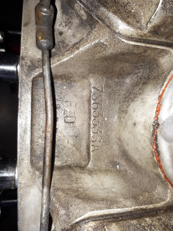

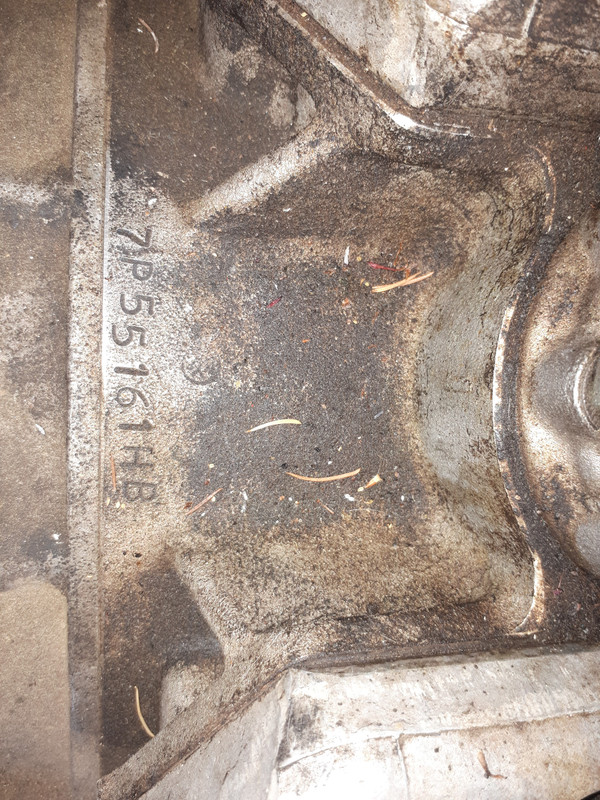

You have preHE heads and, according to my interpretation of engine no’s, a HE engine block. Less issues if I were wrong about this.To double-check the engine block, compare with the following photo’s of where the engine no. is stamped on the block, HE does not have the reduced area between the number and the bellhousing.

I Dont know why my Engine Has been Changed its an American Import ,
The Location and Type Face and Misaligned Stamping is Exactly the Same as ur 7P55 ,

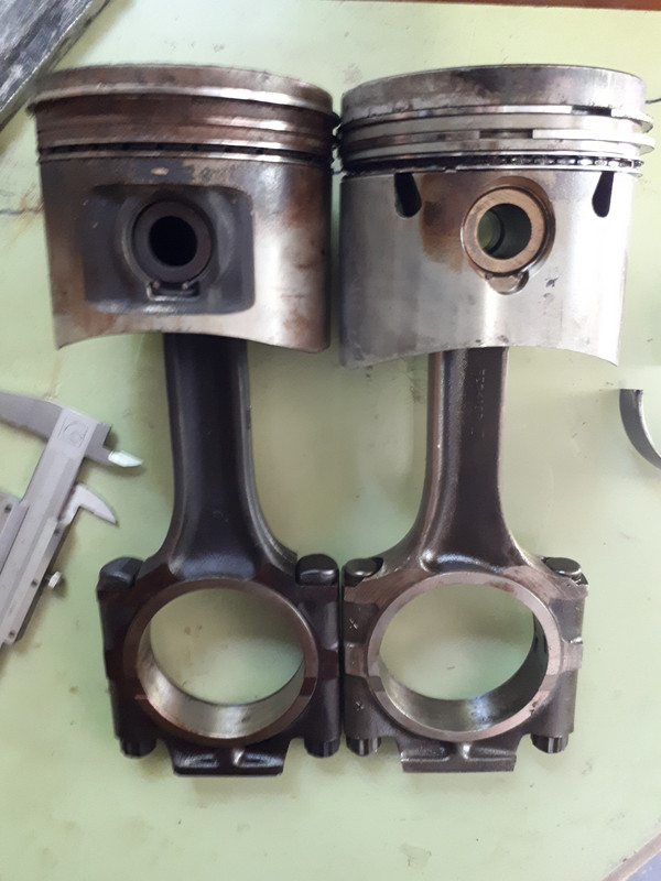

Dirty one on the left is HE 12.5:1 flat top. Clean one on the right is XKE 9:1 (dished).
Subtle differences: rings at different height, skirts different shape, oil holes, etc.
