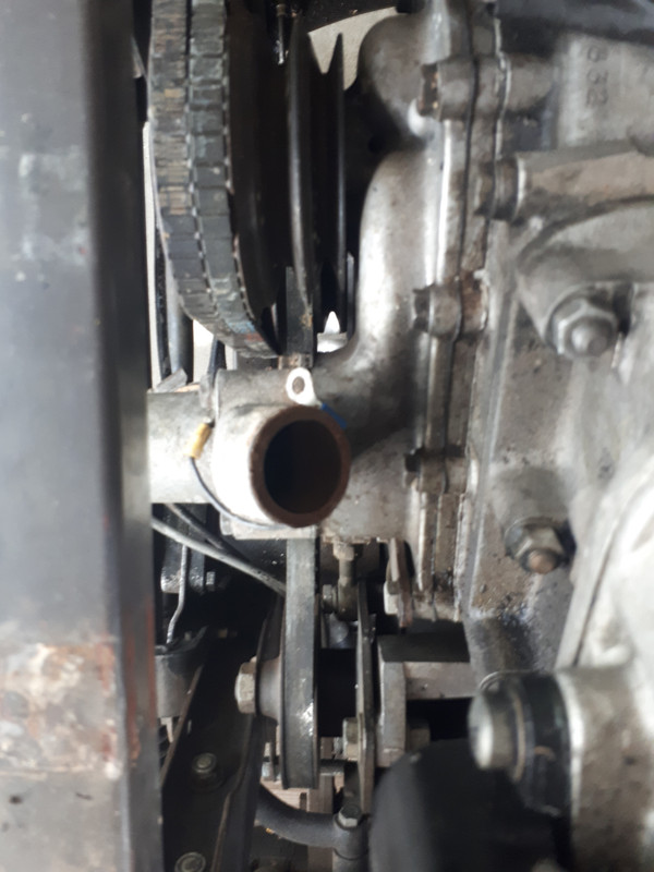

This morning new water pump in place on the xjs engine from my S3.
I though to be on the way to finish the front of the engine, place the belts, the alternator the radiator and then plan to work on the next step : the wiring looms.
I m now stuck because of the crankshaft pulley. The 3d groove is too large for the steering pump belt.
I need to find from an E Type or the one from a V12 XJ s1 ge. It looks like the E Type one. ... :helpsos:

The problem is more that the belt touch the large tube coming from the oil filter than the rev speed from the steering pump. As you said it should work even if it is a bit low.
Because the diameter is larger on the engine side, the belt is too down.

Hello Michel. Paul’s HE XJ12 is probably same as mine (S3, 1886). It has the larger (15 cm dia.) pulleys that are all the same size, no use to you. What vintage is your XJS engine? I assume you have the earlier water pump and oil filter arrangement? On the E-type the steering pump belt runs through a narrow gap between the water inlet hose in front and the oil filter pipe behind. This is possible because the earlier water pump inlet is 2 cm further forward than on the S3 XJ12 with different orientation. On the S3 XJ12 the water inlet is positioned and orientated to be very close to the front of the engine, there is no room for the steering pump belt to pass behind it. I had been assuming I could retrofit the larger capacity XJ12 water pump onto my E-type however this issue you have raised suggests this may not be possible.

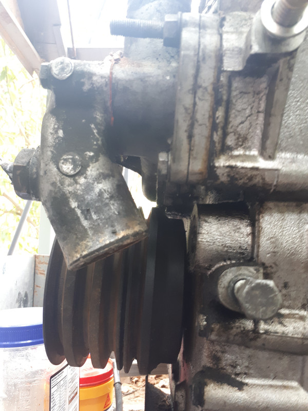

I do not have issue on this side. Only on the oil tube comming from the oil filter. I m far from home. I will try to take pictures closer when I m back.
I can show at least this one :

Hello Michel. My interpretation is that only an E-type pulley will work, part C32528. I don’t believe it was used on any other car, I interpret that all XJ12, XJS use the larger one, part C37892.
Because of the oil filter pipe, only E-types have this (oil filter at the front).
You may need to get a pulley made, should not be difficult?
Where did you get that water pump inlet from? Enables the later water pump to be used on an E, nice!

Go the pulley last Friday.
Close to the XJS one,
Le chemin sera long!...
