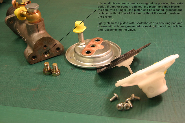

I think you will find the first place to look is the small reaction valve piston and regrease. Attached is a very useful tip sent to me by Eagle. I had the same problem.

#8 Re: S3 OTS Brakes
- Attachments
- 4C21BF70-A707-4334-B019-539845761622.jpeg (119.87 KiB) Viewed 9444 times

Thank you for that. It would seem that you are right, but I’ll do what Barry suggests first.
Barry.
Sorry, I wrote ‘transfer valve’ when it should have been ‘reaction valve!’
Yes, I kind of suspected that the problem was with that valve.
Thank you for the ‘Eagle’ tip, very useful and seemingly easy to solve.
At the mom I am in the Isle of Man but as soon as I return I will have a go at cleaning that piston and I will post the result.
If it works as it did for you, It will save me having to change the master cylinder.
Can’t be bad ......

Hi Paul....before pressing the brake pedal with the valve disassembled cover the end of the cylinder with a rag to catch the small piston......it can fly out with some force when you press the pedal and very easily disappear across the garage....Steve
#11 Re: S3 OTS Brakes
That was the advise given to me too. If you read the caption on the photo it says you need two people, one at each end!
