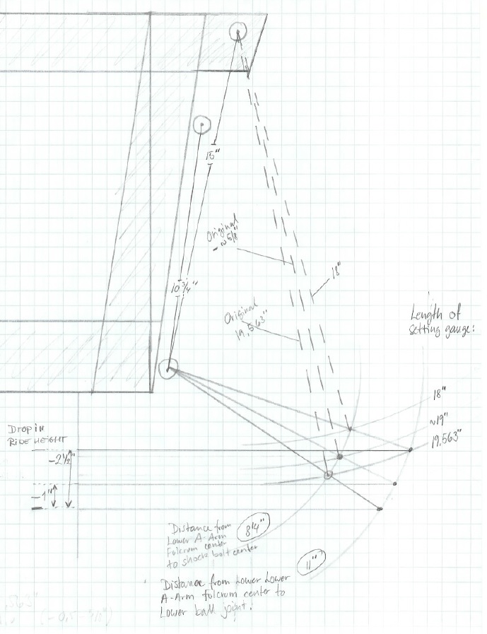

IIRC the fitting of the TBs is done without any tension on the TB. The beauty of the thing is that for a standard strength TB you have a setting tool that position the lower A-arm in a set position (distance between upper and lower shock bolt) and then rotate the TB till it fits in the front and rear splines. That should position the car at a ride height close to what is stated in the manual (6.25") I believe, with the fine adjustment done by the cam on the lower A-arm.
I have fitted uprated TBs and have to come up with a modified setting tool (shorter distance between the shock bolts) to achieve the correct ride height starting point.
Are you gents discussing setting the ride height with full load on the car's suspension ?
Cheers .... Ole

The tension that was on my TB's fits pretty much what you describe. Meaning there was no tension left at roughly setting bar distance when I lowered the lower arm with a jack the first time. In other words, fitting of TB is done without tension, agreed.
But the car was way too low when i got it. So my conclusion was that I need more tension, i.e. that extra spline rotation at the rear as per the manual made a lot of sense to me. I figured the previous owner did not have the JD43 tool and took the easy way out (the car was not driveable anyway)
I have seen other posts that also follow the manual with the extra spline tension and get good results. Then I read other that do not need it. In short, very confusing, assuming we are all discussing the late series 3.
Not sure what you mean?

By fully loaded I mean that the car is on the ground or up in the air, but no parts have been removed (tie rod ends, upper A-arm ball joint, shocks ....) like you'd do when fitting the TB.
Your method is news to me and could be interesting to get my car about 1/2" lower.
