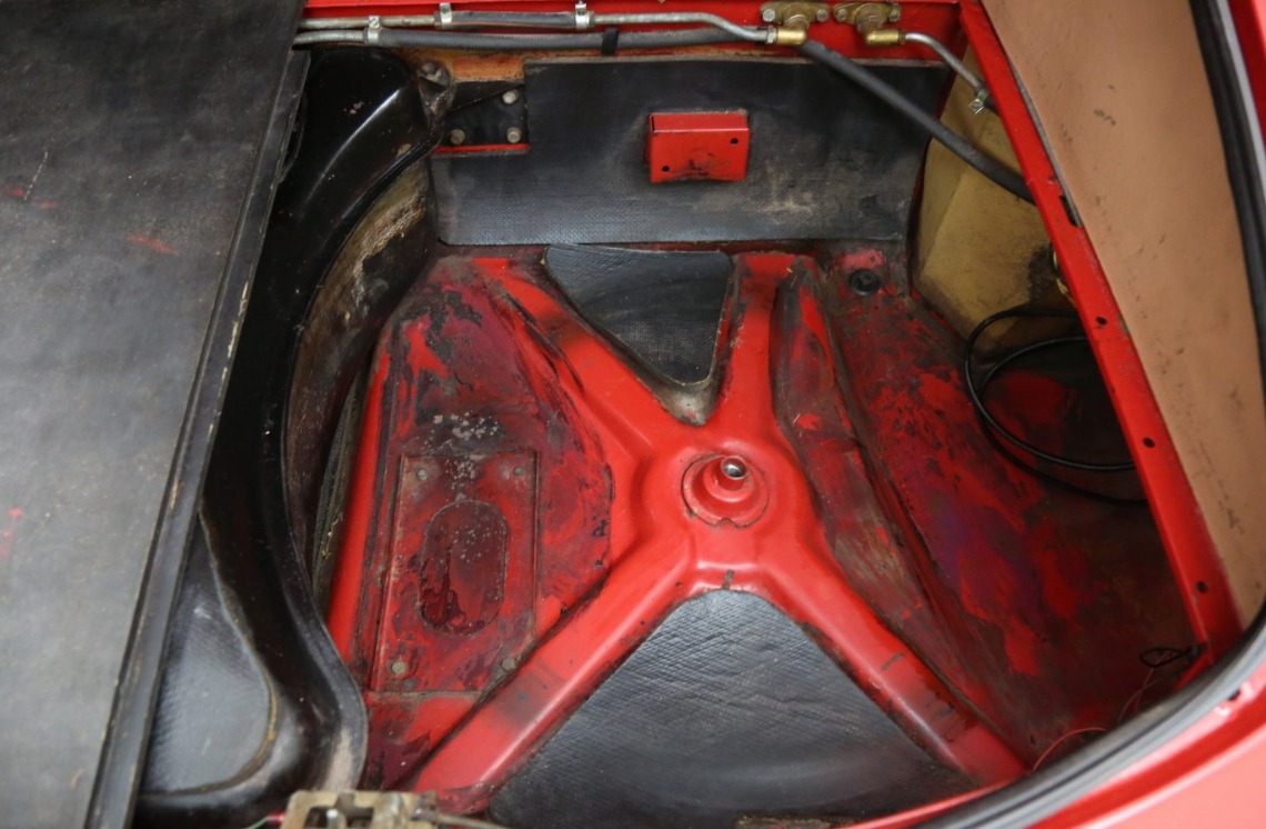

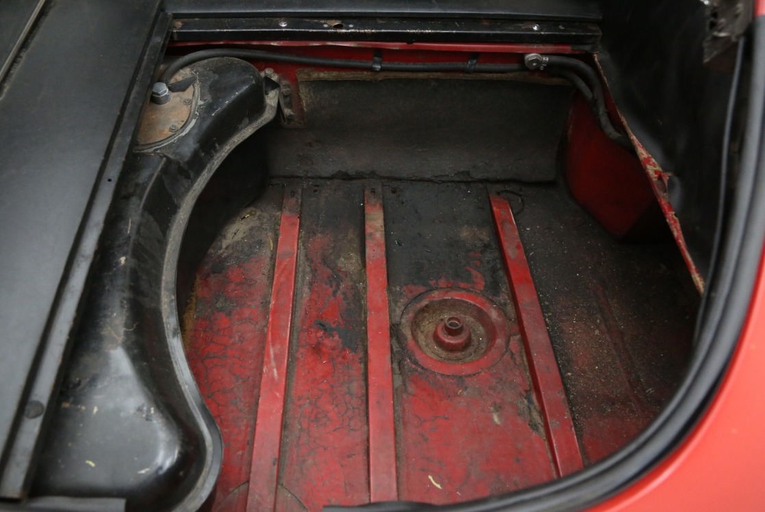

No not a silly question but just a word of caution. Both the standard S3 steel wheels and optional wire wheels left the factory with the spare wheel mounted face up unlike S1/2. Therefore there is a significant loss of storage space as you say and the need for a long hold down bolt. As you found, if you mount a wire wheel face down in an S3 the tyre face is not supported at all and the wheel is unstable with all "wobbling" loads trying to tear away at the few spot welds which hold the wheel locating feature to the face of the floor. I doubt this is the case for S1/2 where the locating feature is mounted below the floor level and I presume (always dangerous) that the tyre face is supported on the boot reinforcing struts.
Original spare (car has done 3500mls from new with original tyre)
These pictures show the difference between S1/S2 boot floor and S3.
S1/2
S3

Thanks for the picture,that makes more sense.Add 35 mm into XJ6 holding down bolt.
