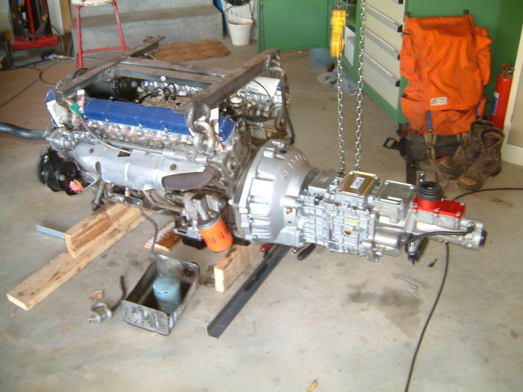

#13 Re: V12 Getrag 265 bellhousing
I fitted a TKO500 kit I purchased in 2004 to my '80 XJS which has the 10:1 Pre-HE engine (same bolt pattern as e-type I believe).
It came with a purpose made bell housing, Fidanza lightweight flywheel etc. I'm not sure I can recommend the TKO500 transmission, it whines in 1, 2nd and 3rd and the throw is very short and "reluctant".
But its lovely to drive once in 5th (0.68) doing 120km/h (75mph) at 1900 rpm on the level (and even most uphills). 4th is 1:1 = same as 3rd in the auto. I've come to realise that the V12 delivers A LOT of torque. Unlike a V8, it just does not SOUND like its delivering torque, even at full throttle.

On the plus side it looks like neat installation and the economy must be far better with the low 5th

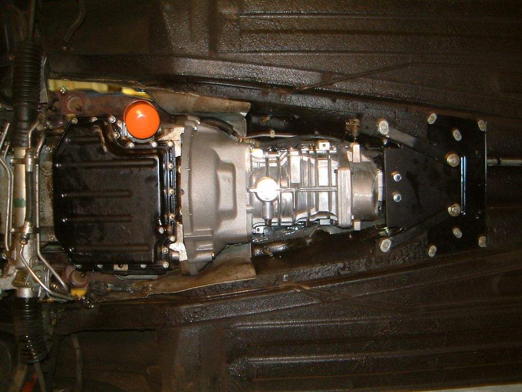

#18 Re: V12 Getrag 265 bellhousing
Some photos:
From the eBay advert:
This is from the eBay advert but is actually my car:
Tunnel cover:
On the crane when fitting to the car:
Home made linkage:
Regards:

Hello Simon
That looks the same as my bellhousing. The photo of the clutch fork is very helpful.
I suppose the most important question is do you like the gearbox?
