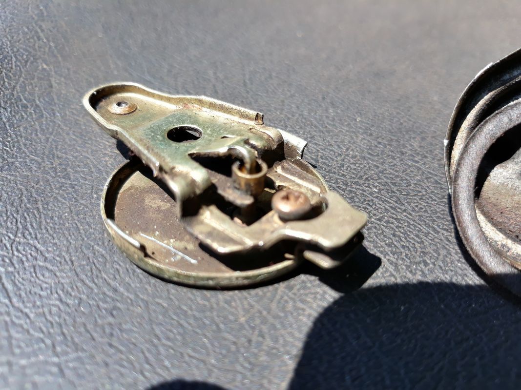

All this work is of no value if the thermostatic “vacuum switch” (C33025, Temperature sensor), situated between the two carb ports inside the air cleaner, does not function correctly. Again I removed mine and first investigated how they work. I opened one of them completely as I could not figure out how they work… Here it is in pieces:
The two vacuum nipples that point downwards towards the crank BOTH feed into a common chamber. This is why it does not matter to which nipple you connect what. One of them is connected to permanent manifold vacuum feed and the other goes to the trumpet/hot air flap servo.
Vacuum will thus come from the intake manifold into this common chamber and will be fed through to the servo UNLESS the “vacuum switch” (C33025, Temperature sensor) becomes hot and then opens a little valve (small round brass piece on left part in pic above using a bimetallic lever). When this valve opens, this common chamber is now exposed to ambient air pressure. This results in 1) the vacuum to the servo disappearing and 2) a “vacuum leak” to the intake manifold. The orifice size in the two nipples on the vacuum switch is very small and thus this vacuum leak is negligible. One of the orifices in one of the two vacuum switches was blocked with residue (no doubt from the fried membranes).
There is a small pozidrive screw on the vacuum switch that determines the temperature at which the ambient air valve will open. To access this screw, it is necessary to remove the plastic housing. Cut off the two “rivet” heads, open the plastic cover and remove the metal part inside. I used a tiny zip tie to close it up again.
Turning the screw clockwise, will increase the temperature where the ambient air valve will open ( and thus remove vacuum to the servo, thus making it switch to cold air from the trumpet). Today was roughly 25ºC here and I turned the screw out such that if I sucked really hard on a nipple (having closed the other one with a finger), I could only just break the seal of the ambient air valve.
