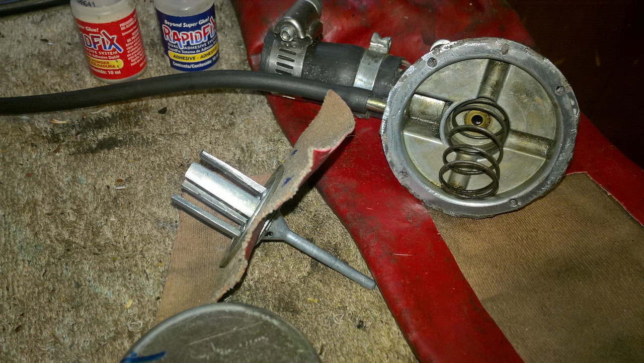

Do you have a gulp valve? This thing (C34018), it is a diaphragm valve that pops open on heavy decel, bypassing the carbs.
Include it in the things to be disconnected and connection (to the balance pipe) plugged. If its diaphragm is perished/split (likely) the vacuum leak can be large and being internal you will not know, unless you take it off and try sucking thru it … NLA and not serviceable, to fix you must cut/prise it open, here is pic of mine during restoration using an old rubber covered glove to make a new diaphragm, incredibly it worked.

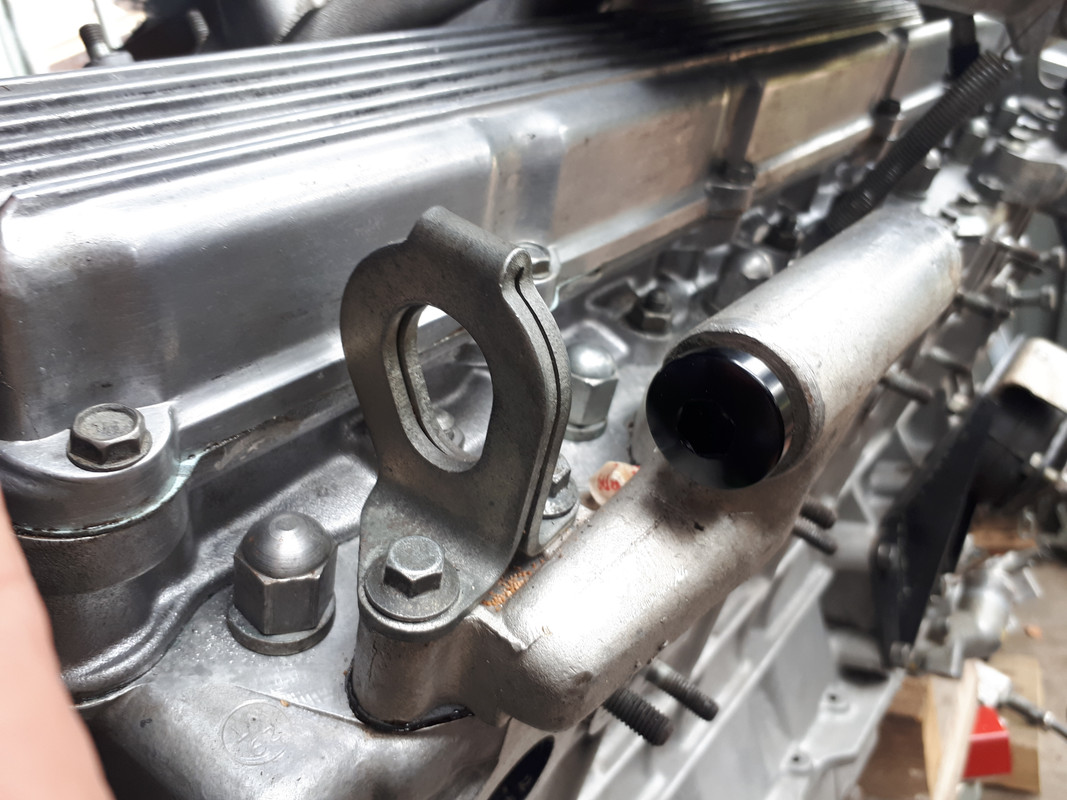

Clever detective work, imo does indicate early non ex/em cars did not have thermostatic valves. Not convinced about late cars however, 25.32 does show the thermostatic valve. Unless there was an undocumented late model non ex/em that didn’t?
What have you got that plugs the hole where the thermostatic valve would have been? What I’ve put on my engine does not look like it belongs …
Here are some vacuum readings fyi. Like you I’d swapped to vacuum advance, drilled a new 1.0 mm dia. tapping point, was very happy with the position, is nicely in the shadow of the leading edge of the throttle plate, I couldn’t push a fine fuse wire through without it scraping the throttle plate.
Note these measurements are with the car stationary so they don’t correspond to driving rpms, e.g. the throttle opening at 5000 rpm when stationary is only a fraction of what it would be at 5000 rpm under load, and vacuum is ~ due to throttle opening (load) … so my assumption is that when driving I would have the vacuum response as above but compressed into a much narrower rev range, depending on gear, maybe 800-1500 rpm (ish), instead of 800-5000 rpm.

Referring to parts catalogue page 30.18 (FHC), you can find the cooling system casting you have photographed in your post. This confirms that cars up to 7S.4879 (NOT EX/EM) have a casting without the take off point for the Thermostatic Vacuum Valve and that after engine 7S.8444, the NON EX/ EM engines did have your style of casting, but now had a plug, part number C.38358 installed, again confirming these later cars did not have the thermostatic vacuum system. Hence, I have nothing blanking the take off, because there isn’t a take off on my car:
Hope that’s all clear,
