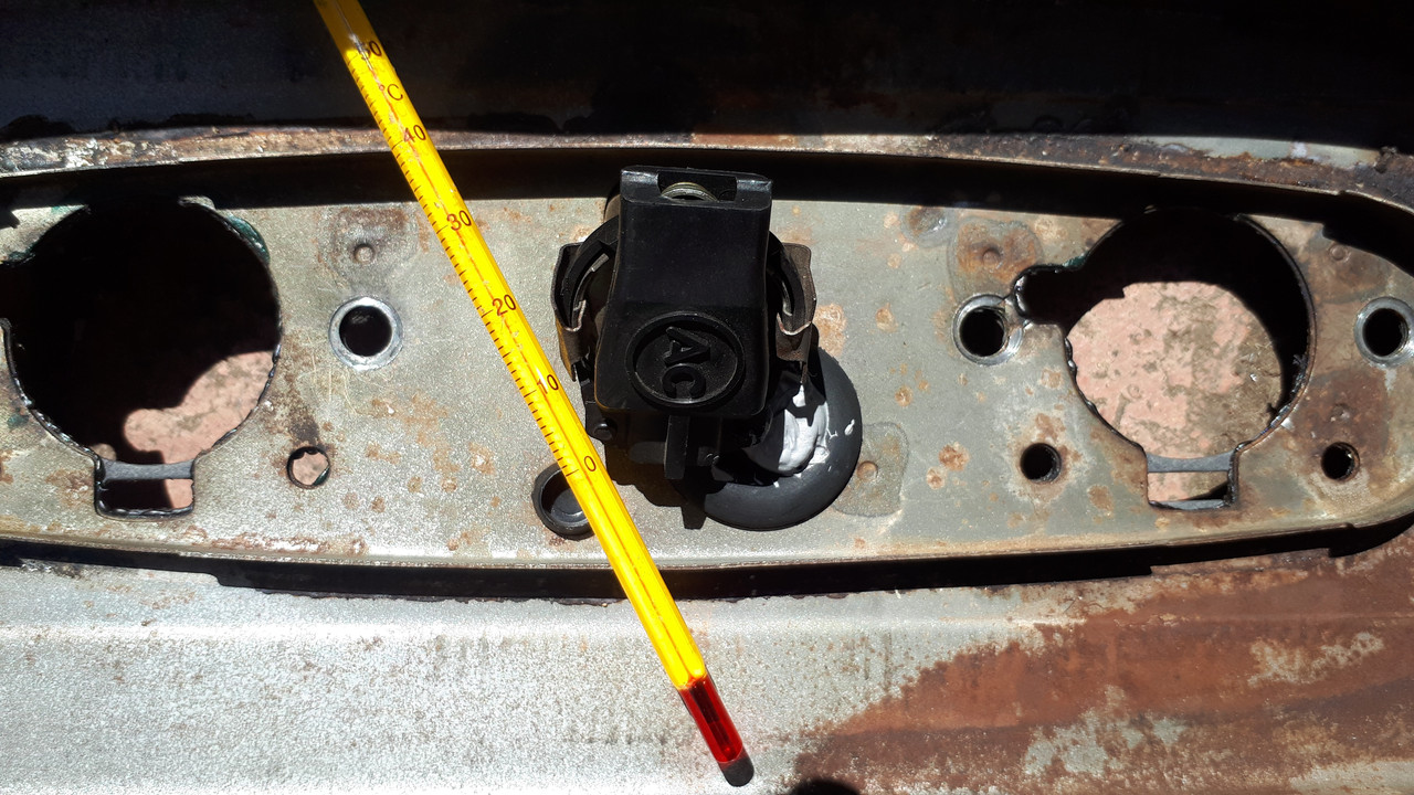

Here is pic of how it should (?) be connected, the OEM arrangement.
Each air box inlet has two openings, the front trumpet and the side flexible duct, the latter provides hot air from around the exhaust manifolds. In the air box inlet is a vacuum operated flap valve. When there is no vacuum the hot air opening is closed, all air is via the front trumpets. When there is full vacuum it is the front trumpets that are closed, all air is from around the exhaust manifolds.
The vacuum line from the inlet manifold to the flap valve actuator is via the “sensor” in the air box. I.e., there must be two vacuum lines connecting to the sensor, one to the intake manifold, the other to the flap valve actuator.
The “sensor” is a bimetallic (temperature controlled) valve, it bleeds off some vacuum to modulate the flap valve so that the mixture of air (from the two openings) is at a relatively constant temperature, so that optimum air-fuel ratio is maintained despite ambient extremes. (air density varies with temp.)
Attempted scientific experiment: Inside (the shed) is 33 degC, in the beer fridge is 5 degC, outside on the bricks is 48 degC.
Using one human sucker, modulation appears to occur within the range 35-45 degC.
