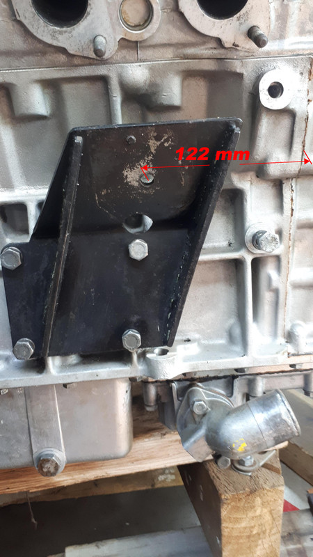

Hello all
Can anybody who has a v12 engine mount unbolted off the engine tell me what angle its bent at, £180 each sounds a bit steep to me for a fivers worth of steel so Im making my own.
Many Thanks

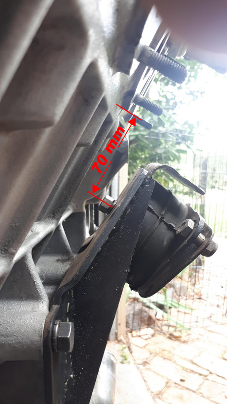

East-west the angle is the same as the angle on the frame mount, also the same as the engine vee, = 30 deg. North-south what is most critical is the location of the centre bolt hole for the rubber mount, I measure 122 mm back from the front of the block (not incl. front cover) and 70 mm below the top of the block (bottom of the head, i.e.:

Hello Colin
Thank you for your posted pictures with dimensions they are perfect, I can make some from here, very kind of you to take the time.
