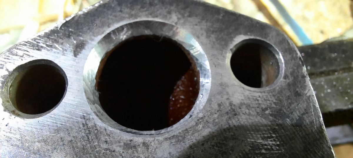

Thought I would offer a bit more detail on what I did:
Grind tapered edge into port using die grinder and bullnose toothed bit (don't know the correct name for this):
tn_Port prepared.jpg (104.35 KiB) Viewed 4820 times
Glue washer in the port - just to keep it there while the manifold is being re-installed.
tn_With SS washer.jpg (90.98 KiB) Viewed 4820 times

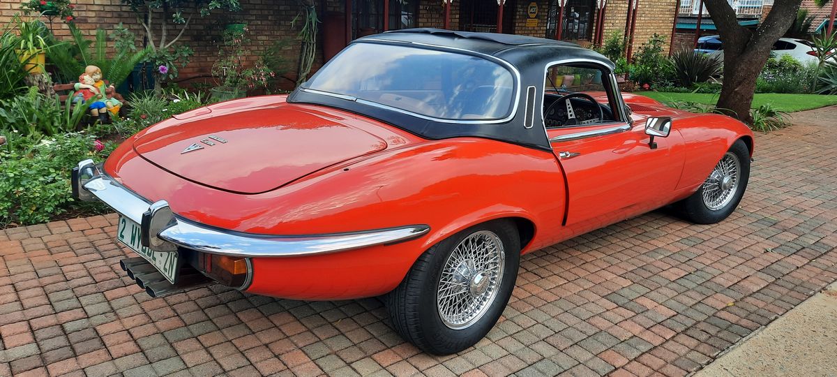

A few nicer pics of the car:

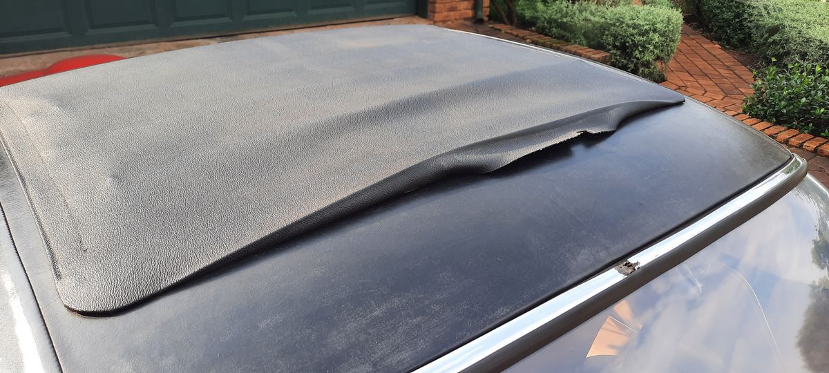

Is that a "sunroof" I see in the removable hardtop of a convertible :lol:
It is indeed!! Crazy.
