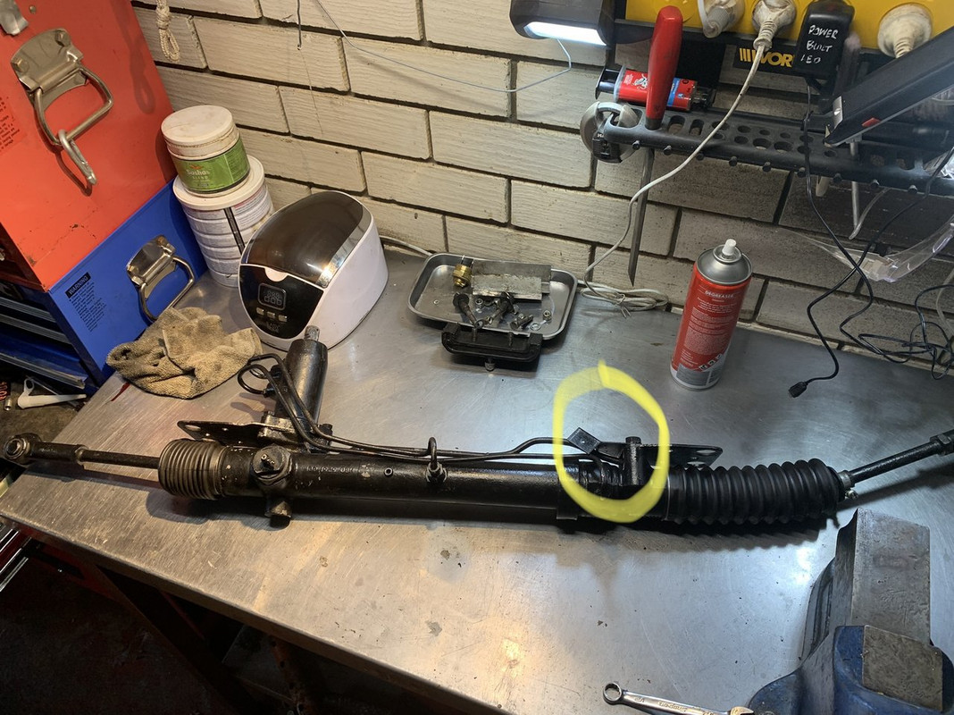

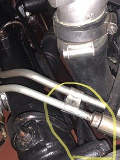

Greetings from down under, good to hear from you. Here’s some photos, a bit difficult to photograph in the depths of the engine bay!
I have a rad cap overflow pipe running down and trapped between my two pipes, so don’t be put off by the thin black rubber pipe. The Union on top of the rack in the picture is the LH of the two and the bracket mounts by the LH rack Mount. The parts manual photo is a good representation of shape.
Simon.

Post by Bob. » Wed Mar 03, 2021 8:59 am
Hi Andrew,
Another couple of photos to add to Simon's. I can unbox the rack and take more pics if you need any.
Bob

#4 Re: Power Steering Hose Bracket Location
Post by andrewk » Wed Mar 03, 2021 11:51 am
Dear Simon & Bob,
This is excellent - all makes sense now and clearly shows where the bracket goes, thank you both so much !
