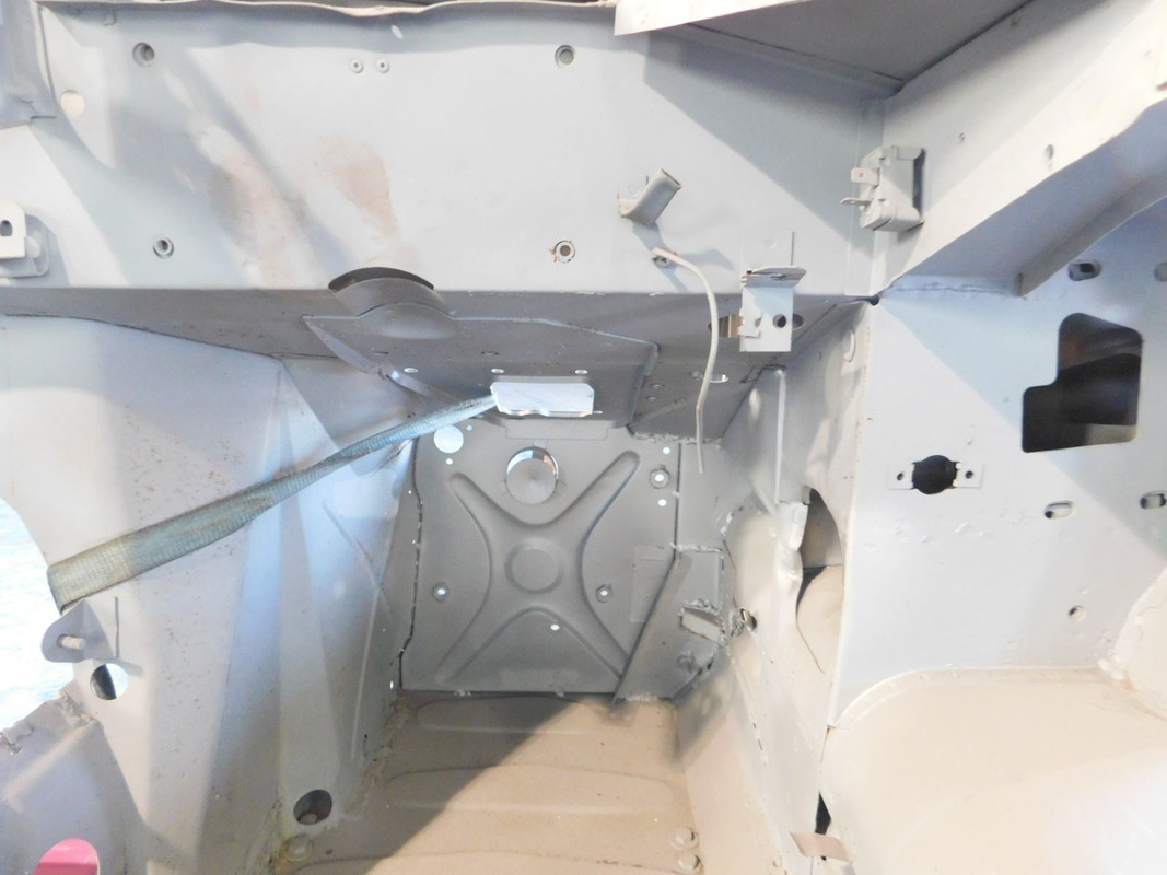

This is probably a numty head question but..
Does anyone know what t(is hole is for in the foolwell of my S3 OTS. (In the centre of the pic)
It was covered by sound deadening material, only discovered when we stated to strip the body of all bits and bobs.it doesn’t really go anywhere and it too low for cabling as far as I can see.
Please feel free to answer with torrential abuse as you see fit.

Hi Peter,
Isn't it to give access to the head of the front bolt holding the torsion bar mounting plates.
Bob

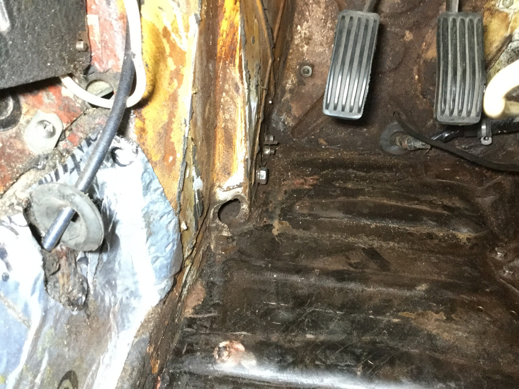

PS Found this picture.
Bob

It enables the starter motor top mounting bolt to be withdrawn (into the footwell). Should have a rubber bung in it.

by Bob. » Sat Mar 20, 2021 9:24 am
Just for clarity -
Bob
