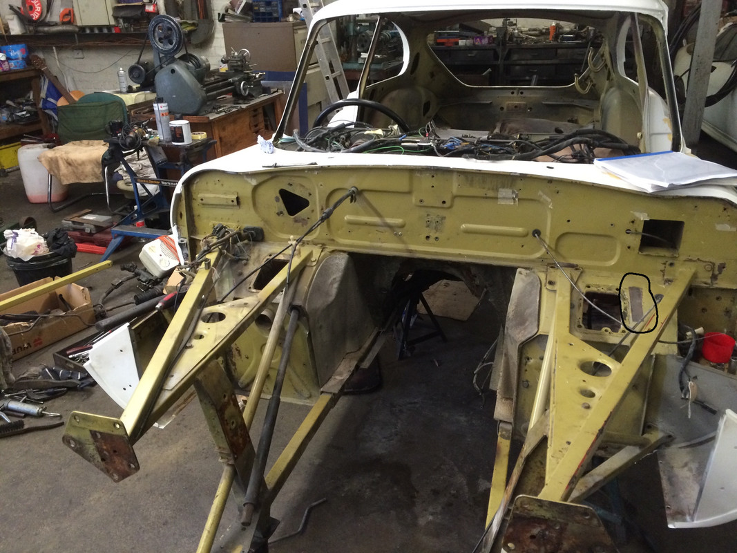

Hi Ellecari
I have a picture of my 73 2+2 which is being restored and repainted. The photo was taken back in 2015. As you can see on the passenger side the chassis number (Circled) has been blanked and the rest painted. I have owned the car since it was 3 years old and there has been no damage/paintwork in that area so must assume that they blanked the chassis number with tape at production.
Hope this helps
Colin

#6 Re: Series 3 E-type Originality Question
Post by vee12eman » Thu Apr 29, 2021 9:03 pm
It looks exactly like mine, except that I removed the paint myself. Please understand I’m not saying Jaguar didn’t do it, just that we’re probably never going to know and they certainly didn’t do all of them.
My car had been painted, but not under the bonnet, which was original and in which the paint was definitely applied over the number.
I have a theory however, I was told to strip my paint from over the number by an inspector. Maybe if the original paint was too thick in that area, some more officious vehicle inspectors required the paint to be removed?
Simon.
