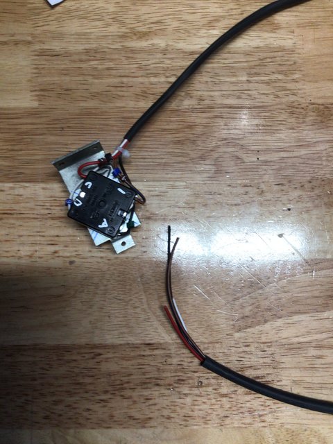

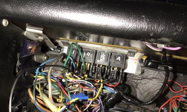

#6 Re: Air condition
1973 S3 air condition.
Here is what I did. I was able to use previous mentioned 4 position switch. Off / 1 / 1&2 / 1&2&3.
Drilled two holes in bracket, mounted it diagonally to get «off» position straight up, with original knob.
Pulled the brownblue ( energizing switch ), blue ( low fan ) and green ( medium fan ) wires out of the front case and routed them up behind the dash and into behind instrument panel. The brownblack wire continue down to the fan so I left it in place. But I spliced into it right before it enters front case with a wire and routed this the same way.
Now 4 thin wires ( one with power from brownblue with 3A fuse, and three for low, medium & high ) runs from the swithc behind front case and up behind instrument panel, were I also located the relays.
I never got clearified if medium really needs to be deenergized when using high so decided to wire up so it does. Needed four relays, one for each position ( 1, 2 and 3 ) and one ( a ) to deenergize relay 2 when selecting high. The relays is glued to a 1mm alunuminium sheet folded 90degrees.
There is sheet metal in the «ceiling» above fuses with some slots, clipped the relay bridge into one of theese slots as deep and high as I could. It clears all other components in there. But since it is located just above open fuses/fuseholders I covered aluminium sheet with tape just in case it should fall down.
It works just fine.
Then I took a look at the original switch and there was a very neat indentention just were the spring blade rests at «low». Sanded it lightly with fine emery and filled it with polyester. ( The stuff boat people are using after they forgot to navigate ). This seems to be working fine, over time I don’t know, but this switch is going back next time I have to dig in there.
Harald
