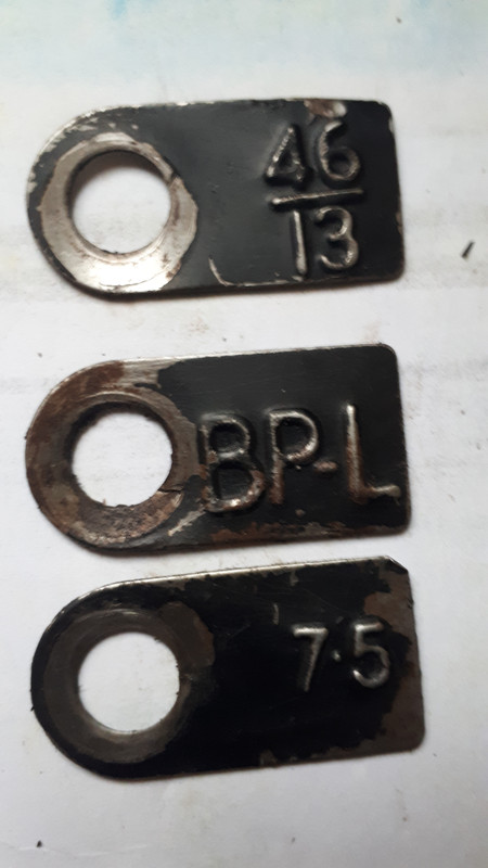

3.07.
There should be an aluminium tag attached to one of the rear cover bolts with a fractional number on it. Top number divided by bottom gives your ratio.

#7 Re: Diff Ratio
My diff had three tags:
46/13 was the ratio (= 3.54).
BP-L i guess is what it is, the "P-L" probably stands for "Power-Lok"
I've no idea what the 7.5 tag signifies.
