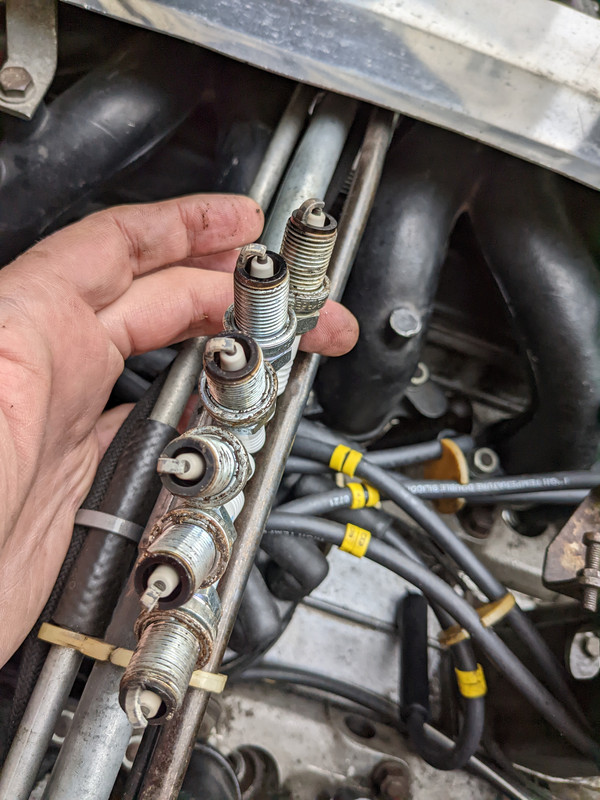

Car is running great. I rebuilt the fuel pump last week due to failure there, everything is sweet and purring like a kitten, theres always been a slight wobble at idle like a V8, carbs are tuned well enough I believe, maybe timing miss? I don't know, it's never bothered me, doesn't impact driving, and it's not getting any worse so I've never chased it much.

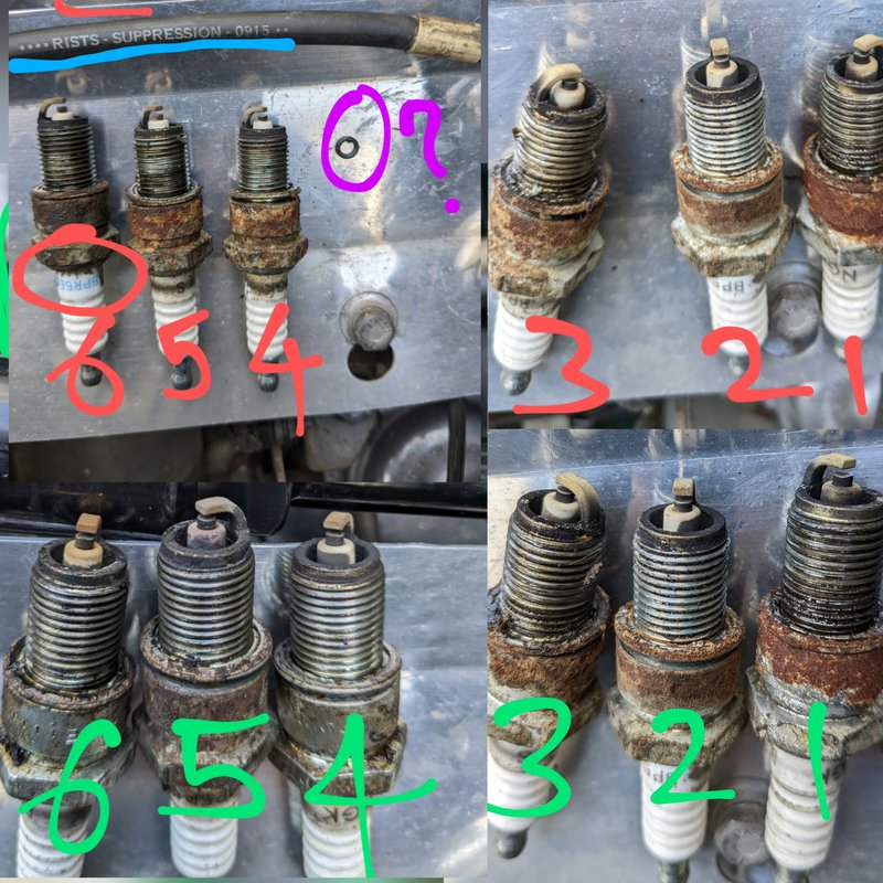

Today I pulled the spark plugs just to check them since it's been a while.
Green side (Right bank - from drivers seat) seems to have the more questionable plugs 1&5 dark, 6 quite brown
The other side looks good, perhaps #1 is slightly dark.
I was reading the other threads on this, does any of this mean anything anymore?
Gaps were all at 32thou or so. I have set them now at 25thou - haven't driven it yet, runs fine, but it did already.
only one of the plugs is resisted, the other 11 are not, the leads are a total mix, a couple of 8mm leads, some unmarked and some that say resisted some don't. - Why do I get the sneaky feeling if I put this all right, the engine is going to run worse :bouncyyellow:

With unleaded fuel plug colour is less useful. Having said this they all look on the lean side to me, and the difference between them is marginal if any. If the car's running well I wouldn't worry.
Neither have I. And your plugs were really rusty too. Do you live by the sea?

Update. I readjusted plug gaps and the pinking is sorted. I had left them a little bit wide, as that's what the previous ones were, but nipping them down to the 25thou solved the pinking. I'm yet to tackle the vacuum conundrum. I've read the monster thread here in the forum. manifold Vs ported, I wondered why there is not more chat about the microswitch thingamajig suggestion, sounds like the best of both? I've seen a Stromberg available online that already has a port, perhaps from a triumph? but also aware these things are setup as pairs. I can turn a bolt as well as the next guy, but I'm well outside my knowledge for the finer workings and implications of altering parts of this system. I'd like to decide before spending money on changing the vacuum unit.
A wealth of articles online about reading plugs, from what I gather mine look hot due to the almost the entire electrode colour, I would have thought also lean, but there is a clean dark layer all the way round the base ring. No splattering. On balance I think they're ok, again, running fine. (At least, no worse than before, but could be better).
