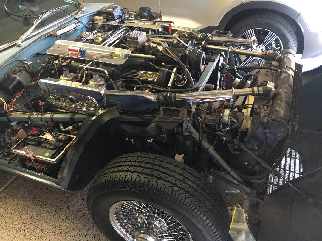

A different view of the engine bay. Concours judges and experts please advise on all problems and errors....
