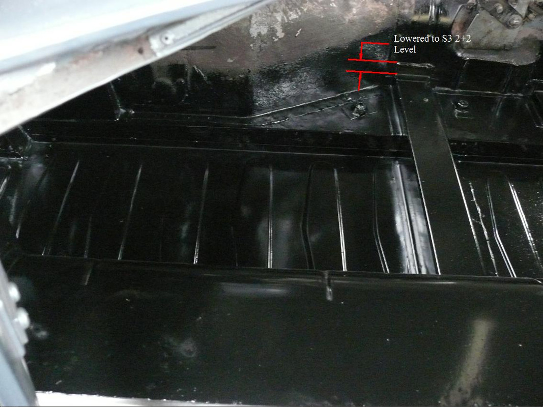

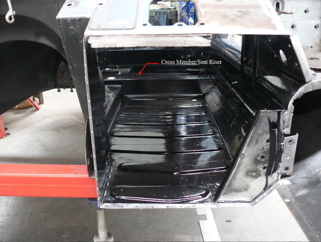

When replacing floors in S1/S2 2+2 or any S3 cars, we provide the client with a choice of a variety of Cross Brace/Seat Riser heights.
S1 and S2 2+2 cars have the highest seat riser height of all models, to the point where the height can cause difficulty getting in and out of the car due to the clearance between the steering wheel and the seat cushion. Next highest is the S3 2+2, with the S3 OTS having the shortest in height seat riser.
The following picture shows an S2 2+2 that has received new floors and the seat riser the height of the S3 2+2 fitted.

Hi Bill, that explains everything, crossbeams are different heights ...
My OTS, top of cross-beam is 65 mm above the floor, seat diaphragm is only a few mm off the floor.
