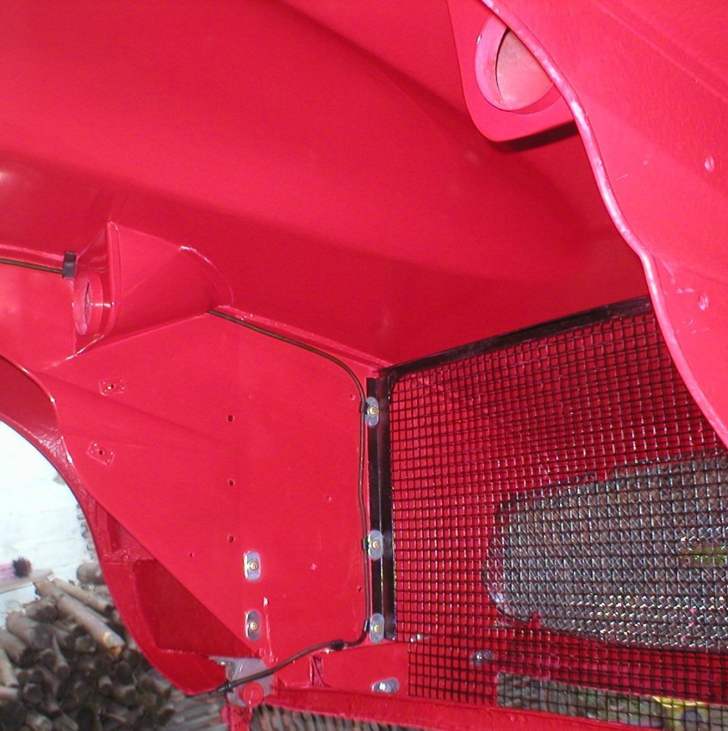

You've not told us what the chronic problem was. The limiting factor for cooling is when airflow and waterflow are at a minimum, so "hard running" ought not to be a problem.
The radiator foam to redirect probably was the easiest and most sensible alteration. The air will always take the easiest path, so forcing it through the radiator rather than allowing it to go around will make a massive difference. The shroud on top of the radiator already has foam, but this would be more useful if it were to extend further.
The ducted air ought not to have any effect on engine cooling.
