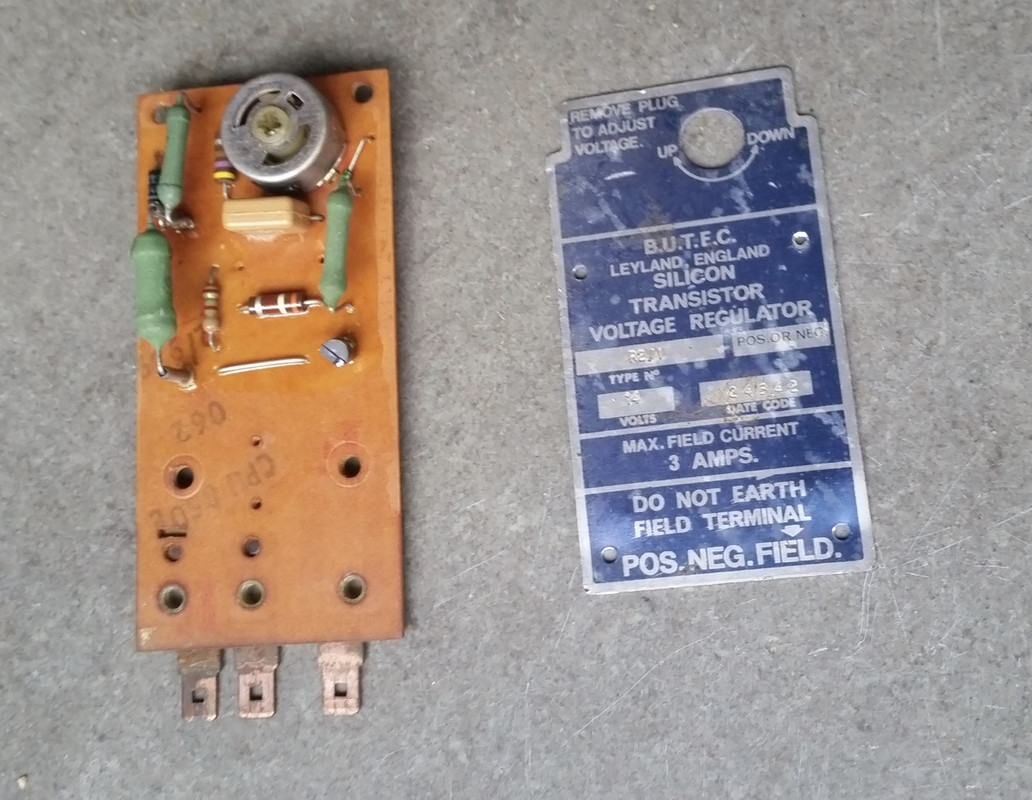

Ive had charging problems...initially the alternator wasn't charging. I found on stripping it down that there was a bad earth on the diodes. It is now working but I'm getting 18.5V across the battery when engine running.
So I've now turned my attention tp the voltage regulator as shown in the pic. Ive read that its fairly easy and cheap to replace the diodes and transistor...., Ive easily found all parts apart from the fawn coloured capacitor (?) which appears to have been fried.(small pool of gunk under it)
Printed on it is ITT-GB PMT/2R and on the reverse .22/100.
So my question is have any of you tried to repair one of these and what do these numbers mean?
Thanks!

:bigrin: 0.22uF 100 volts. Get a 0.22uF polypropylene capacitor with a working voltage of 100 volts :bigrin: I do wonder if the gunk is actually glue holding it firm against vibration. Plastic film capacitors don't contain anything that can ooze out. Your cap may be fine....they are pretty robust.

Thanks Julian,,,,it dosent look like glue (but it might be!) I have noticed that although it looks un-corroded there is lots of corrosion between the spade terminals and the circuit board so Ill clean them up and test it without changing any transistors etc.
....and yes it is an originality thing.....all components on car appear original and id like to keep it that way if possible.
Thanks guys for your replies and Ill post on the retest.
...Oh and one more question...does the alternator generate an unregulated voltage (ie 18.5v in my case) and if working correctly the VR regulates this back to around 14v....or how does it work?

The alternator will generate 18 or more volts if the regulator is dead....and this voltage will rapidly damage the battery. Provided the regulator is working as it should the voltage at the battery and alternator main terminal should be around 13.5 to 14 volts give or take a tenth of a volt or so. Any more and it needs adjustment of the regulator or you will over charge the battery. I would aim for about 13.8 volts. Or a couple of tenths lower if it is a maintenance free battery you cannot top up.

Once you have read the description, you'll realise that the most common problem, the alternator output remaining at 18v+, is due to its field winding being permanently grounded, either through bad wiring, or because the big transistor in the regulator permanently conducts (keeping the field circuit permanently connected).
