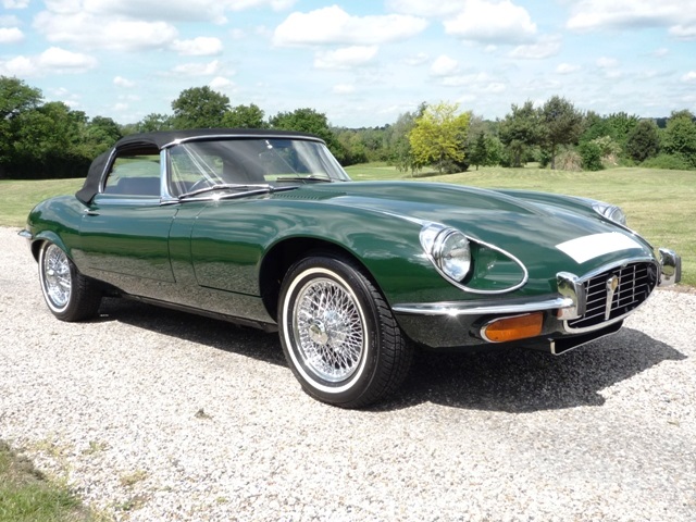

The original Jaguar British Racing Green is quite a dark green.
My car is the Lotus BRG such as used on the Lotus 49 of Jim Clark from my childhood.
Quite a few people ask what colour it is and have had their cars painted in it.
It is quite a bright green in the sunlight :-
A bit in the shade here :-

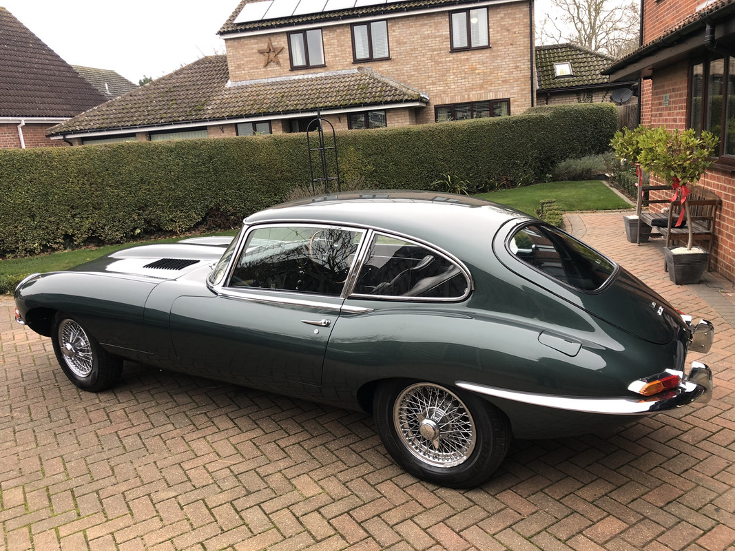

No such shade as BRG as someone has already said.
The E Type colour was opalescent dark green. The codes do exist but you can’t find a manufacturer who can supply to them. I just had mine painted in opalescent (a reflective Sandy grain rather than metallic particles) which looks fantastic. I chose from four or five swatches and compared them to the original paint on the inner sills which had never been faded.
Very pleased with the result. Sunlight and shade change the colour quite dramatically.

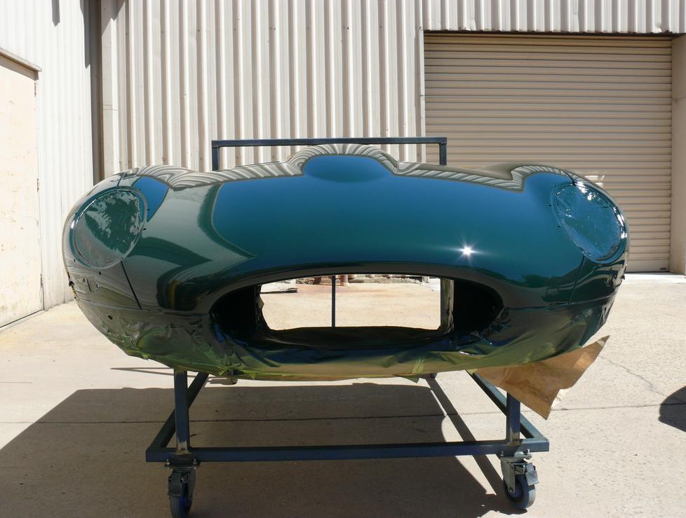

MaroonV12 Wrote:
I comprehend your comment "The E Type colour was opalescent dark green" meaning that the Dark Green used on E Types was only ever a metallic dark green. Not so, there were various shades of solid dark green that were labeled British Racing Green used on E Type Jaguars; the same as there were many variations of Signal Red used throughout the years on Jaguar Cars. All documented.
Ash Wrote:
@kevh
A paint finish that included a flattening agent will change over time with polishing, even with low levels of flattening agent. Accordingly, I suspect that you will be disappointed with the result.
As there are a myriad of Dark Greens labelled British Racing Green, just select any Dark Green that you like, have your car painted that colour and call it British Racing Green; no one will be able to dispute it. The fact is, if you were to take a car of any colour and have the colour identified using a Spectrometer Auto Paint Color matching System, the resulting colour is likely to be from a totally different make of vehicle.
We recently completed a restoration on an S1 2+2, where the client had selected the Dark Green labelled Neo Green used on the MX5 sports car. Now that its on his E Type, he calls it BRG.
There are many Dark Greens that are refereed to as British Racing Green and indeed there are paint formulas that are specific to Dark Green Colours that were used on Jaguar cars and referred to as British Racing Green.No such shade as BRG as someone has already said.
Ash Wrote:
Off the gun, modern paint systems have a more gloss finish, irrespective of whether its two or single pack system, than the paint systems used circa the time of the E Type. However, once cut and polished, there is little difference.Generally modern paint (2k) systems are much more shiny than the alkyd system used originally on the s3 E type so if you want less shine your painter can add some matting agent if you want.
@kevh

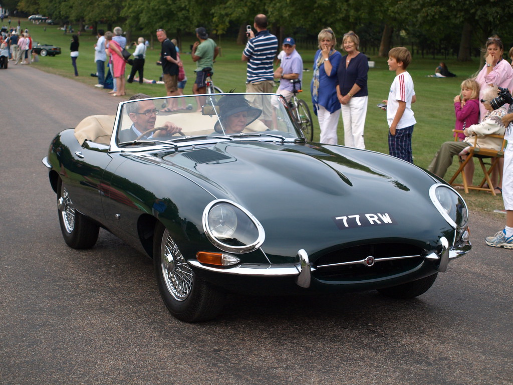

I believe the early dark BRG was carried over from the C and D-Type racing cars and was used on S1 3.8 and 4.2 cars. Opalescent Dark Green is quite a lot different.
Look at 77RW which is a good reference.

#19 Re: British Racing Green
Except 77RW isn't in its original paint. If I remember correctly it was restored around 2001. Looks great though.

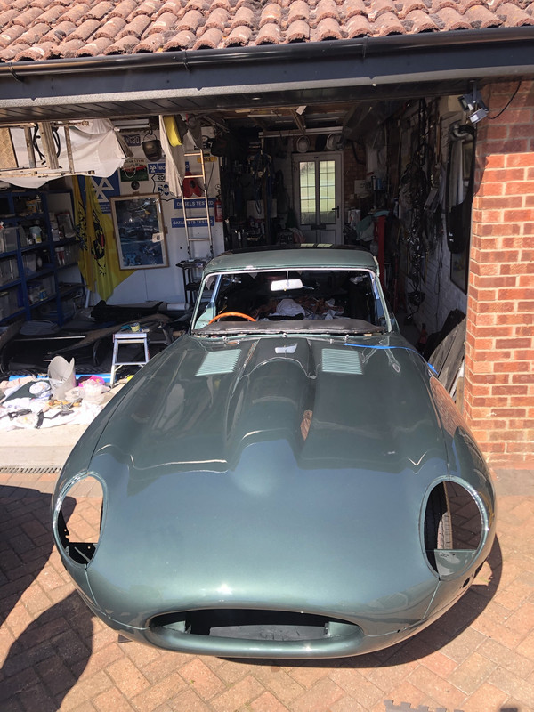

#20 Re: British Racing Green
Ash Wrote:
Its quite difficult to compare paint colours on different days, different locations and in different light conditions. The prevailing light conditions of the pictures of 77RW and the S3 appear to be quite different. And 77RW, as Stuart points out, has been restored.
The colour of the Bonnet in the picture in my Post #9 looks quite different to the one below. These pictures were taken seconds apart, using the same camera and clearly in the same light conditions but with areas on the bonnet below in a shadow of itself.
In bright sunlight, the completed car looks more the colour shown in Post #9 and very, very dark out of the sunlight.
Opalescent Dark Green isn't all that different to many example of BRG, only its metallic. Also with metallic paint, a myriad of different shades can be got out of the one and same spray gun pot of paint, just by varying the spraying technique.
