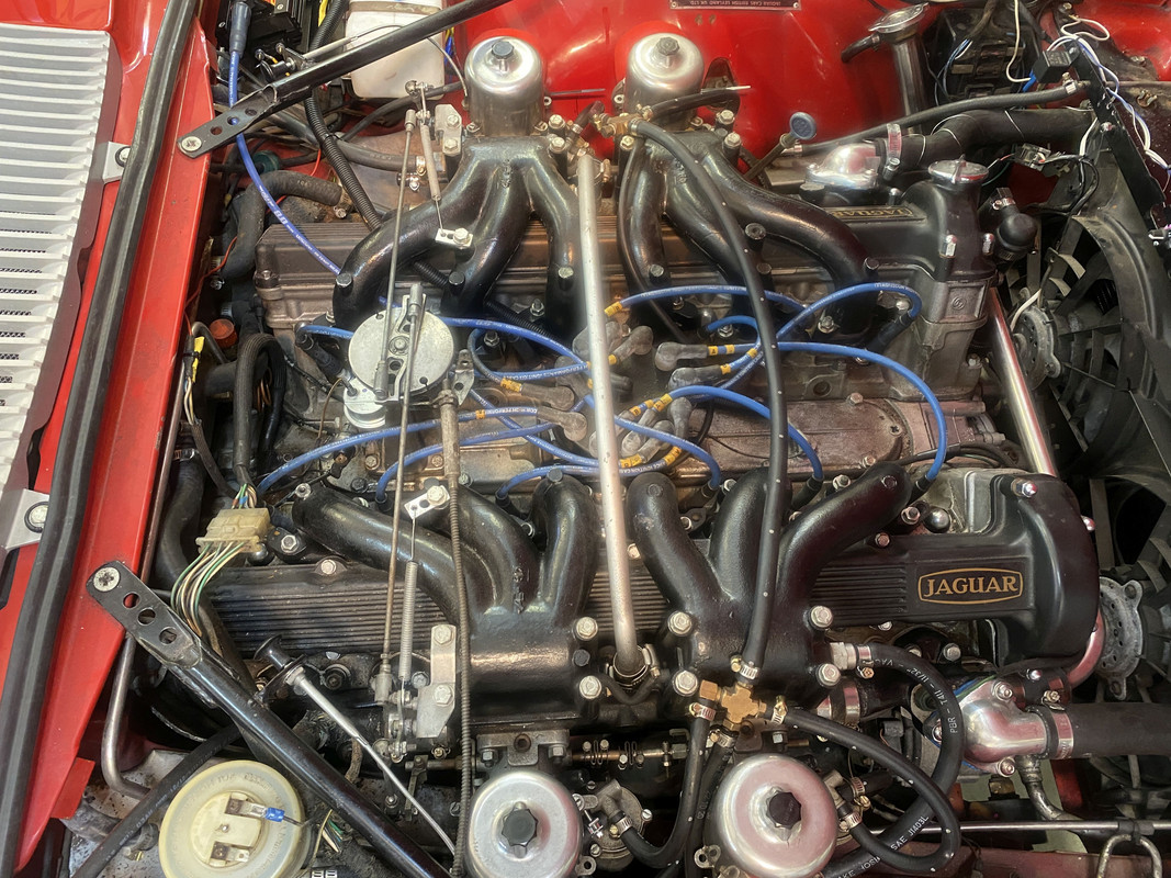

I have a 1975 XJS with this under the bonnet.

How did it manage to get carbs on it. Is it a early XJ12 or Etype engine or the original XJS engine with the injection system taken off and carbs put on.

Post by abowie » Thu Jan 06, 2022 7:07 am
PO I think.

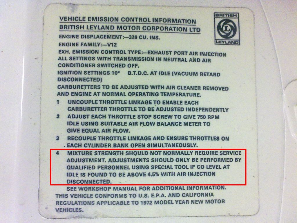

The only place I recall seeing Jaguar quoting a CO figure for the S3 E is on the underbonnet sticker of 72-74MY emission control cars. Basically adjust if found above 4.5% (with idle timing set at 10deg BTDC, vac retard and exhaust air injection disconnected).
