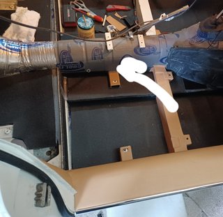

:P Hi all,
I m not sure if there is or not a piece to stick on the tunel before the moquette.
Any advice ?

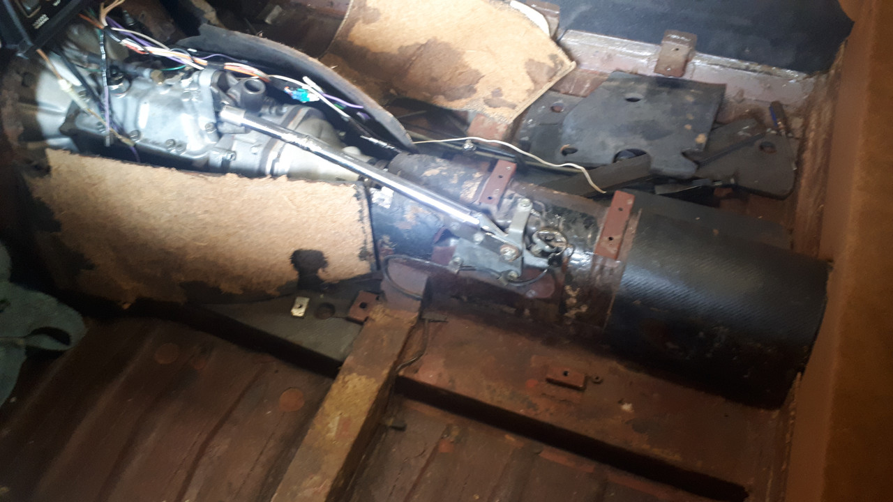

There is not any hardura on the tunnel adjacent the handbrake, between the tunnel opening and the rearmost console mount. Instead there is a 1-2 mm layer of hard set mastic (on top).
Everywhere else there is hardura, spare parts manual is accurate depiction.
