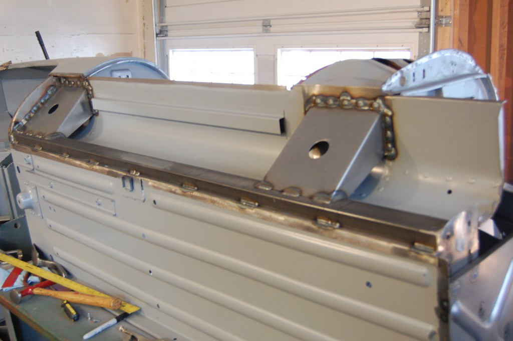

#5 Re: Scuttle shake
You may want to reach out to Chuck at Monocoque Metalworks
https://monocoque-metalworks.myshopify.com/
He has kits to stiffen the sills with stronger gussets and a steel tube (the gussets have notches built-in to accommodate the steel tube)
He also has a kit that fits behind the seats on the floor that run from sill to trans tunnel on both sides.
Although I don't recall any kits or mods to address specifically scuttle shake -- he may have something that'll help
Admittedly, Chuck specializes in 6-cylinder versions, but he has bits for the Series III as well.
