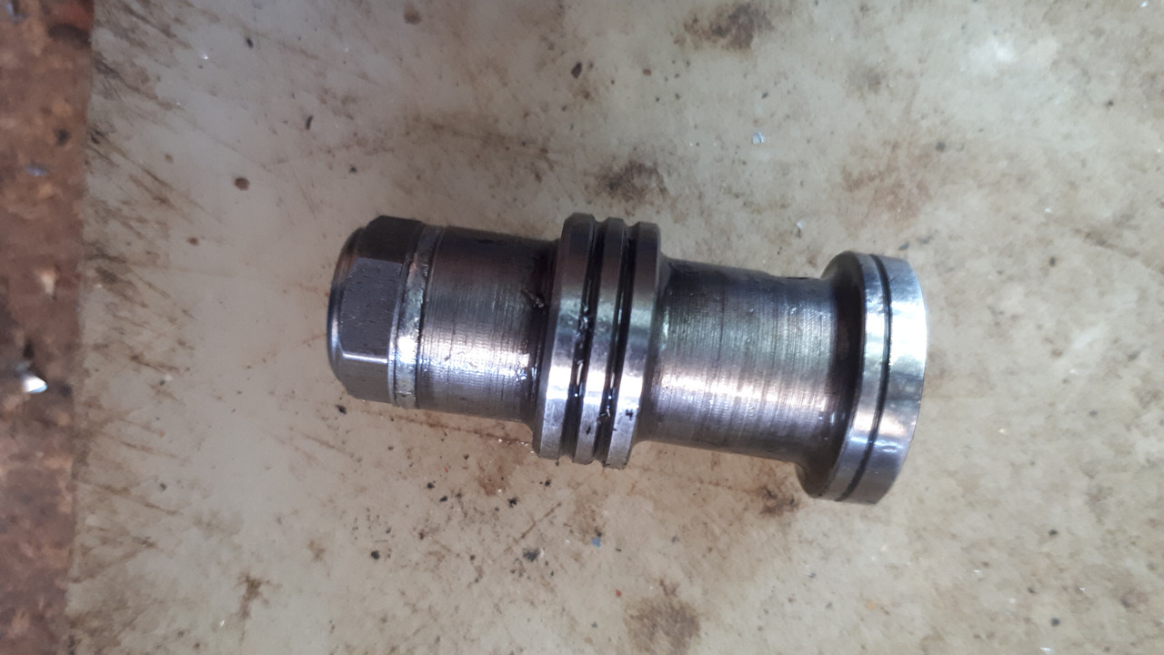

Should there be any seals on the control valve in the steering pump?
There are a couple of grooves halfway along the assembly that makes me think that there should be, but I cannot recall seeing any on it when I took it apart. I have checked the parts catalogue and there is no indication that there should be.
Cheers, Matthew

Post by Motionwork » Sun Apr 10, 2022 2:59 pm
Photo of the control valve.

#3 Re: Power steering control valve
Post by lowact » Mon Apr 11, 2022 11:04 am
No. Do/did you have an issue with the steering? If not ...
Now that you have it apart, you could add the washer, per the Jaguar tech bulletin; this reduces the power assist to improve steering "feel". Here is mine with washer installed.

#5 Re: Power steering control valve
Post by MarekH » Wed Apr 13, 2022 6:04 pm
That valve is a relief valve - it only sets/adjusts the cap on the fluid pressure.

#7 Re: Power steering control valve
Post by MarekH » Thu Apr 14, 2022 5:41 am
A correctly working pump will always produce lots of pressure anyway.
Removing a shim will make the maximum possible pressure increase because the cap is set higher. If you don't have a high fluid pressure to start with, the valve and its shims etc aren't in play at all.
There should be plenty of information about Saginaw pumps on other forums.

#8 Re: Power steering control valve
Post by lowact » Thu Apr 14, 2022 11:18 am
Also youtube video's of Saginaw pumps, i found very useful.
The Jag mod was to add a 50 thou washer (1.27 mm), i doubt removing a thinner washer would make noticeable difference even if u did have pressure.
Might not be a pinion problem or pump problem, could be the rack piston seal is leaking ...
