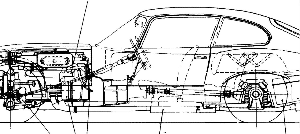

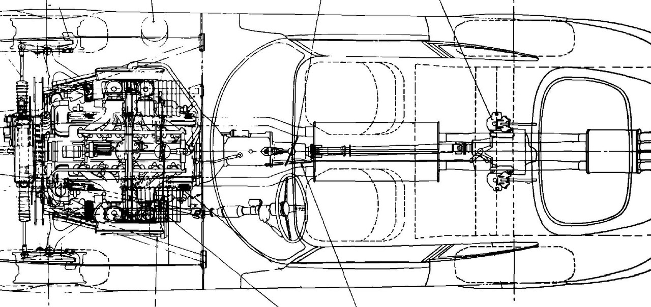

Hi Steve,
I don't recall seeing any published figures for driveline angles but, if accurate, these two technical illustrations from the original S3 press release appear to show that in the static condition the design intent was that the gearbox output shaft should be horizontal with offsets which appear to be of the order of 3deg vertically and 3deg laterally to the diff pinion shaft.
Hope this helps,
Bob
Bob

Thanks for the pictures Bob. It appears that the engine sits level but it looks like the differential pinion angle is up, but how much? Oh well, the measurements will tell.

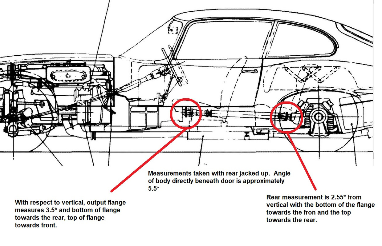

Post by Sdinse » Fri Jul 04, 2025 12:09 am
Finally got around to work on my Jag once more. Moved to a new town, downsized house for retirement going from a 2 story with 4 car garage to single story with a 2, remodel, remodel, remodel; you get the idea.
I had mentioned earlier that I had questioned whether my IRS was assembled correctly.
Unless maybe, they didn't put back my original dog bones?
Now that I've been able to get underneath and take some measurements, I'm REALLY curious what the various angles in my driveline should be.
I jacked up the rear only and this allowed me to install the correct manual transmission spacers that go between the body and the mount plate at the tail end of the trans. I originally had the spacers installed that came from the factory which were appropriate for an automatic, way too thin.
NOW it's time to take measurements!
Now I have read that parallelism is important between the flanges and the measurements tell me that my flanges are out of parallel by just over 6 degrees. :shock: This is what makes me think again about dog bones (inner fulcrum shaft mounts). I would like to verify that mine are correct for a SIII since I've heard that these are what determines the installed pinion angle. With all of my measurements taken relative to 0 degrees vertical and the car jacked up at about a 5.5 degree angle, I also measured the bottom plate on the IRS cage at about 3 degrees, down in front. If my calculations are correct, that would mean that the IRS when level would have a nose up angle of about 5.55 degrees. Does this sound right? I also noticed that in the diagram provided by Bob (which I repurposed, thank you Bob), the flanges do NOT look to be parallel.
Questions, questions, questions. Anyone got any answers?
1971 SIII E Type 2+2
